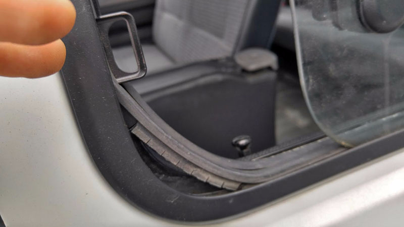

A Delica I'm looking at in Oregon has the gasketing pulling away from the windows. I've heard from several L300 owners that this is a common problem.
Is there a good source to buy replacement gaskets/weatherstripping? (FYI, I'm in Portland, OR if that matters).
Thanks in advance.

No help with the source of new weatherstripping, but I fitted some generic dual-sliding-window weatherstrip to an L300 a while ago. It wasn't quite the right profile and needed a bit of work to make it fit- trimming a little from here, a bit from there, cutting drain holes, and a bit of contact adhesive to make it sit right in the corners, and the windows were a little tight afterwards.
The upshot is that if I were doing it again, I would check the price of genuine Mitsubishi replacements and fit them if it's in the budget. (you've seen the part number finding guide in the FAQ, right? viewtopic.php?f=16&t=17210)

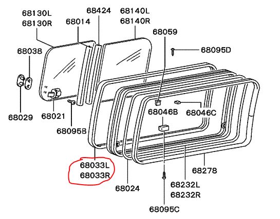

I see there are "rear" and "QTR" windows. Are the QTR (quarter) the rearmost side windows (half slider, half fixed)?
When it comes to replacing those run channels (aka gaskets), is it just one part number per window? It looks like the run channels are two separate pieces per window, but there's only one part number for each window:
These are the part numbers:
Right QRT : MB416314
Right Middle: MB478210
Sliding Door Window: MB416313

NewDelica91 wrote:If you entered your vehicle info correctly then that should be the correct part. If in doubt call for help
I don't doubt the accuracy of the part number. However, is the "QTR" window the rear-most side windows?
Also, are those run channels one piece or two? On our van it appears they're two. Perhaps when you buy new ones that part number actually is a two-piece unit?
And I assume these circled numbers are the run channels?
