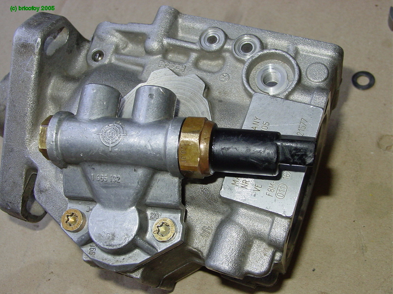

I'm going to presume it's not the turbo. It's odd that it only shows up when it's warm. Does your injection pump have a cold-start doohickey? It'll be on the end of the advance plunger like so:
...though the appearance might be different. If you don't have one, that position just has a metal plate with two screws, and an o-ring behind.
I ask because that's the only thing I can think of that deliberately changes with temperature. If you have one, then maybe it's not assembled correctly.

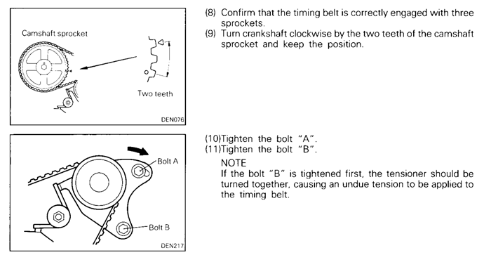

If it was a new one I think you need to check your timing again (as well as checking the shaft and bolts) :-(. When you installed the new timing belt, did all the timing marks line up perfectly? It's easy to slip one tooth on the crank sprocket while installing the belt and not notice, that's why they recommend turning the engine over (by hand) two full revolutions and confirming the marks still line up. When you check your timing marks, if one is a full tooth out it's probably just that the belt slipped during install. If it's half a tooth out, it might be a worn key or keyway on the crank.

It jumped a tooth.
No power when warm
Confusedone wrote:It jumped a tooth.
That'll do it. Bugger. :-( I've done the same thing, but caught it before trying to start the engine. I think I skipped the "turn engine two teeth forwards before tightening tensioner" bit.
