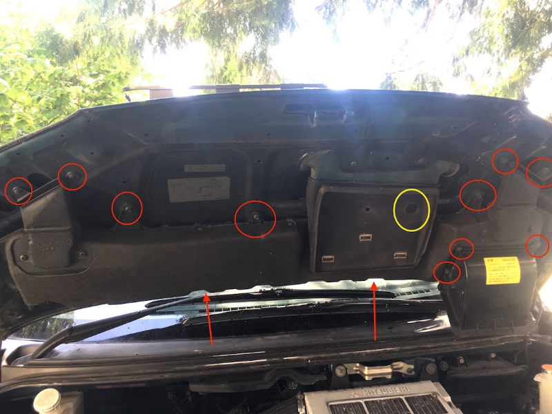

First open the hood and remove all the bolts holding the cabin fresh air intake to the underside of the hood (I believe there were 16 screws/bolts altogether - not all are indicated in this pic).
Also remove the 3 grommets holding the rubber boot for the turbo fresh air inlet (one is circled in yellow).
There is also a row of bolts on the underside (area is indicated by the arrows)

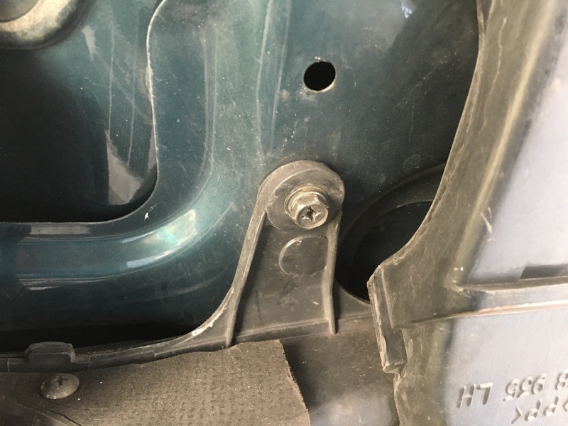

Heres what the 10mm bolts look like. There are also 6 phillips screws.

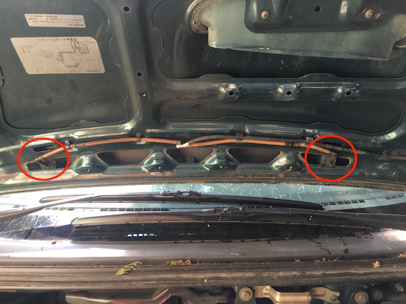

Once you get the fresh air intake off you will see the hoses and nozzle locations. You may be able to work from here. I disconnected the hoses and blew compressed air back from the nozzles. Then blew out the lines. That cleared them out.

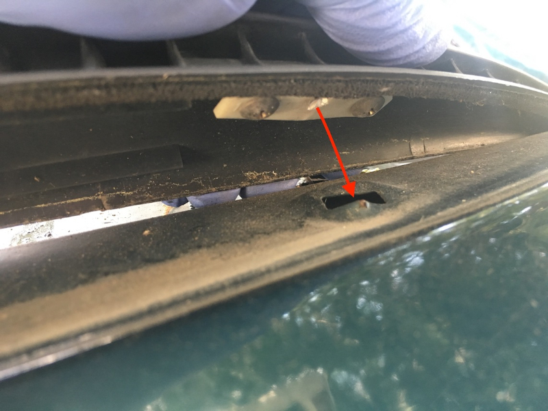

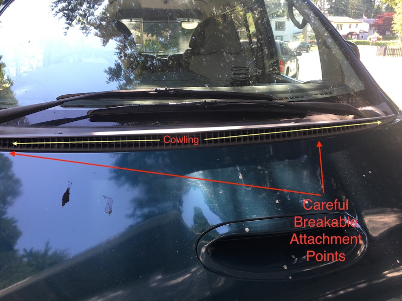

Last time I fixed them I had to remove the cowling (for lack of a better description). from the top side of the hood. Be careful as there are two snap in connectors on each side underneath. They are pretty brittle. I broke the first one as I didn't know they were there, then tried very carefully to remove the second one. It broke too. Arrows show the approximate location of these snap in connectors. Be patient. Both mine are broken but the cowling still stays on as there are several other push in connectors (different type) as well. So if/when you break those 2 outside ones there are others that will do the job.
This is how and where they push in to the hole in the hood (or used to).

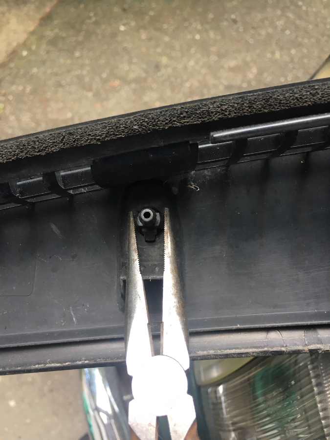

Once you get the cowling off you will see the underside of the nozzles. Remove the hose and use needle nose pliers to gently squeeze together the retaining clips. The nozzle comes out easily.
