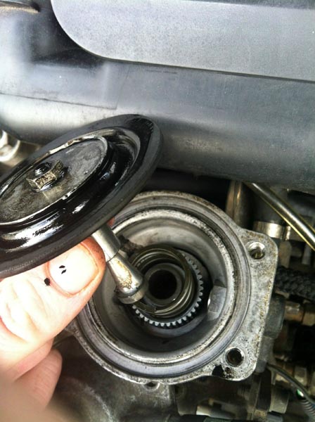

When adjusting the boost compensator is removing the nut above the diaphragm required or is it just rotating that nut and diaphragm in tandem?
Injector pump throttle arm shaft adjustment
joebillhill wrote:When adjusting the boost compensator is removing the nut above the diaphragm required or is it just rotating that nut and diaphragm in tandem?
No need to remove that nut when rotating the diaphragm, the whole diaphragm/nut/metal plate/control shaft/cone rotate as one unit:
Rotating the diaphragm moves the offset cone towards or away from the control mechanism, changing how much fuel is injected by the same amount at all boost levels. If your engine smokes almost all the time (acceleration, steady cruise, light traffic) rotate the diaphragm to move the cone towards the front of the IP.
Winding the serrated wheel under the spring changes the spring tension, causing more (or less) fuel to be added when the turbo's boosting. It doesn't change the fuelling at idle or under light boost. If you only have smoke when driving hard, wind this up.
