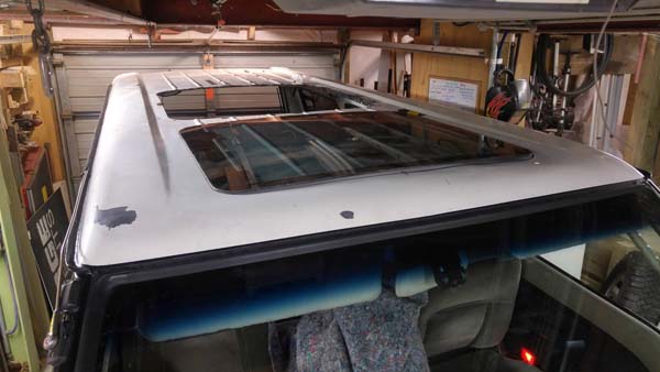

20170613_123336_HDR copy.JPG (25.28 KiB) Viewed 14582 times

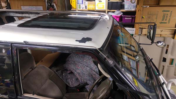

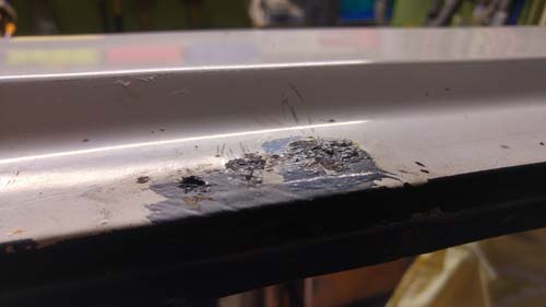

Bugger. There's a tiny spot of rust showing around the sunroof. Guess I better see how far it goes.

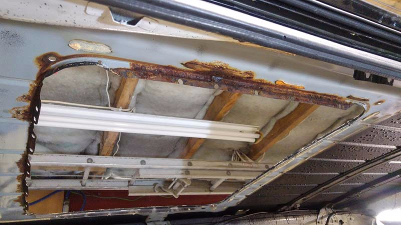

*Insert swears here. Many swears. Quite loudly*

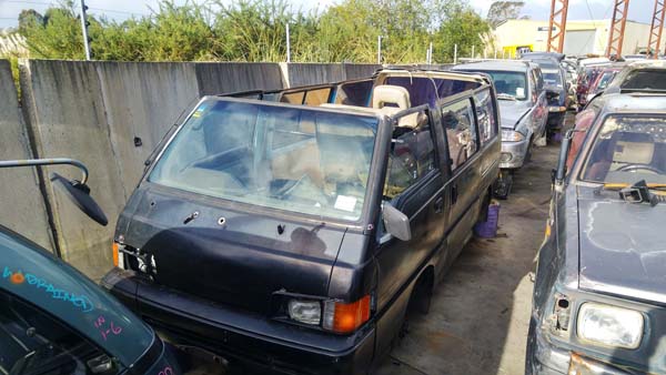

*thinks* I don't have rear seats, it seems a waste to have that giant sunroof all the way in the back....
*Insane idea forms. Measuring commences*
...to be continued...

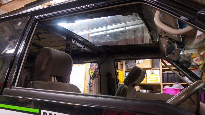

Sunroof rust repair: Madness may ensue, as usual.

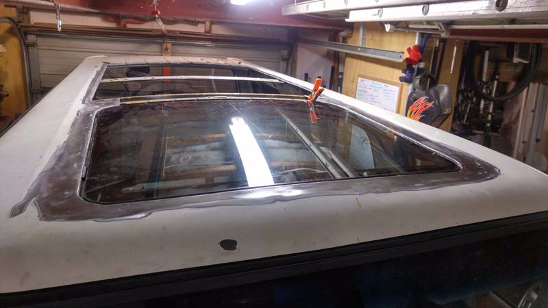

After a few hours of measuring, and calculating, and measuring again, I took the plunge and chopped a sodding great hole in the cab roof.
And what do you know, the glass looks *good* in its new home. The curved front edge matches the curve of the windshield, so it even looks like it's supposed to be there. Which is the point.
Now the small task of making flanges for the edges of the hole, mounting the glass, and all that.

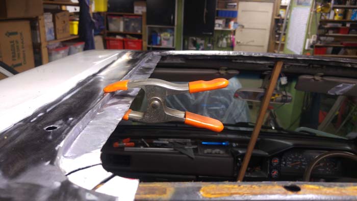

Making slow progress, mainly because I keep stopping to re-measure everything.

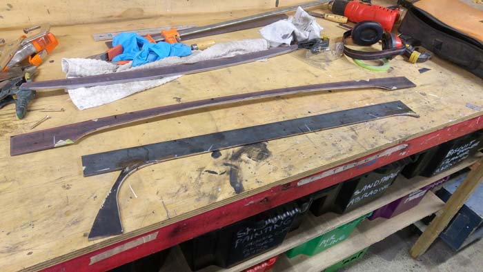

First up, I've made a couple of formers with the desired shape for the flanges. Clamp them to the sheet metal and hammer the metal over, and I should end up with a flange that's flat and straight. -ish.
After a couple of days of hammering, we have flanges. They're not beautiful yet, but they're close.
And the glass even fits! Bonus!
Next I'll be reshaping the internal support structure to fit the new roof sheet metal. I'm starting to realise just how much work I've taken on, and how long it's going to take. There are steps that must happen in the correct order (like priming all the steel before bonding anything in place), and that's going to slow things down quite a bit.

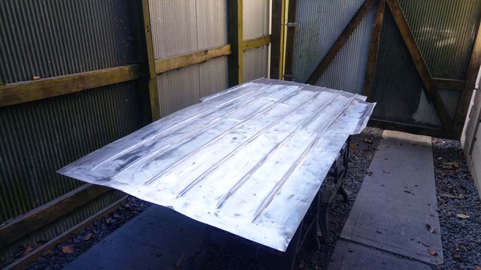

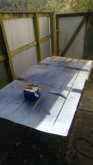

And now the job I've been avoiding- stripping all the foam, glue (various kinds), and paint off the new roof.
Gross. 4 hours and 3 clean-n-strip discs later, and it's ready to be fitted. Interesting find: this roof has been 4 different colours. Baby blue, then white, then high build primer and white again, and finally matte black. No wonder it was so heavy.
After I flange the edges, test fit it, prime it, test fit it again...
Interesting fact #2: L300 Delica Wagons have their roof bows attached with panel adhesive. L300 vans are attached with spot welds. I guess it's cheaper, but noisier?
