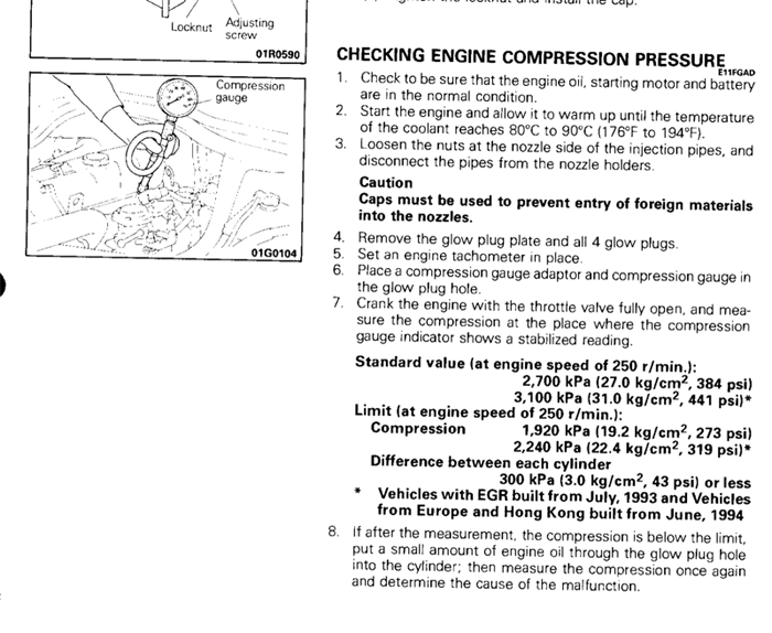

Those numbers are very low- the workshop manual says the lower limit is 273psi:
That said, a compression test is only meaningful if everything in the intake system is also within spec. If your clogged air filter causes 1psi of pressure drop, it'll show up as a 21psi reduction when compressed (in theory ;-)). Your valve clearances also need to be correct before the test (0.25mm when the engine is hot), if they've closed up a bit your compression readings will be much lower. EGR/blowby gunk clogging the intake manifold and valves can also restrict inlet flow and lower compression readings.
I'd do a tune-up and test the compression again.
