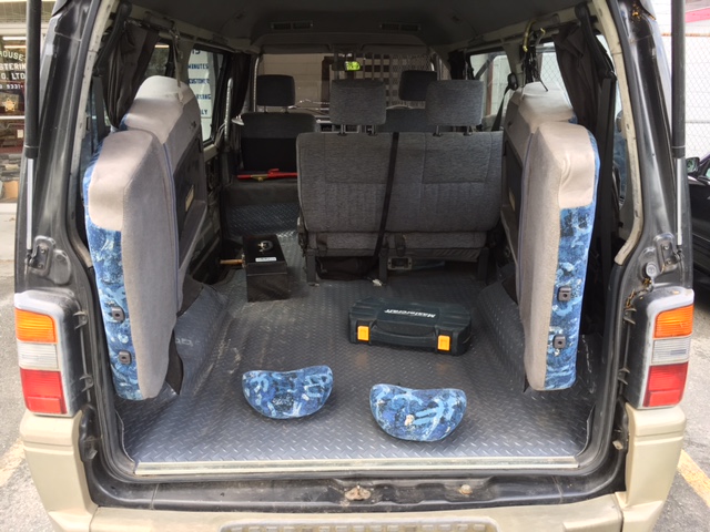

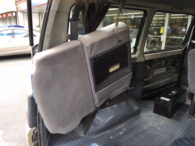

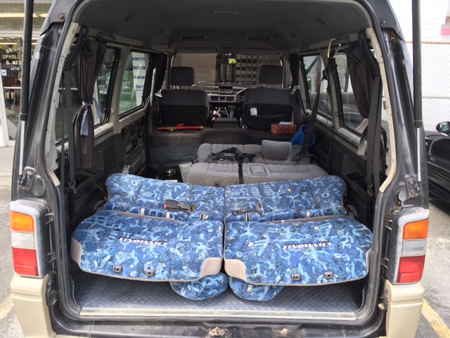

Sweet. Picked up some L400 chamonix rear seats for my L300 chamonix. Amazing auto had them. Hard to find in good condition. See pics for how it will work. Have not found metalworker yet but will take project into Vancouver Metalworka next week. Tirewell mounts will be dead simole but am going to get a floor "bar" solution doneso the seats have something to click into for seafety purposes (don't collapse on passengers!) will post final details back here for any Lower Mainland L300 drivers who wish to replicate! Andre

Curious on the forum's thoughts on my plan for the metal bar running across the floor for the seats to click into. This is neccessary to keep them from collapsing (e.g. accident, bouncy logging roads). I have a sweet custom garage liner floor you can see and I laid it on top of the original carpet. I also want the option to only fold down one seat at a time so I need a stationary, permanent bar and/or floor brackets.
The other option is to lift up the garage liner, cut out the back half of the carpet, replace with plywood and install with some brackets the seats click into. I don't really want to put any holes in the liner though that is why I am thinking the bar running across the floor that is welded to the brackets.
See attached. Also trying to find a good metal working around Vancouver who wants to tack this on as it's tough to "pre-measure' any of this. Let me know if you have a guy!
Andre
