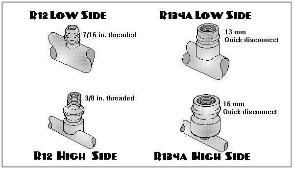

Mine had a service sticker under the engine cover saying "R12". The definitive way to check would be to look at the fill ports:
I had to add R134a adaptor fittings. They just screwed right on.
