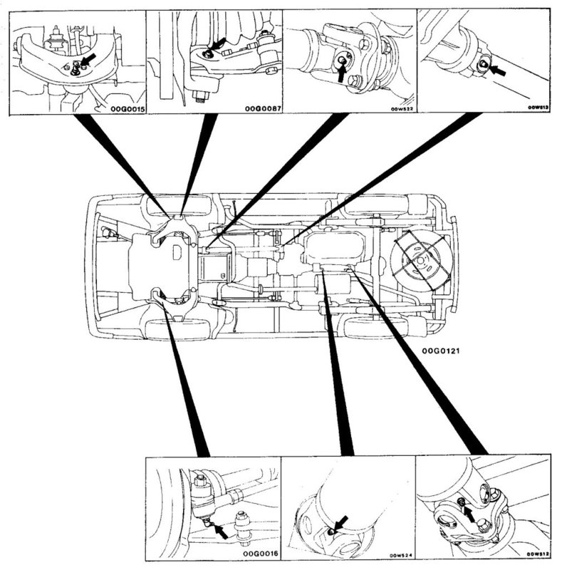

Hey everybody I have a question about grease points for our L300's. I was reading through another forum (I don't remember which one) I came across article where they had mentioned grease nipples and I was wondering if anyone on this forum had seen or heard of this? I have attached a pic for anyone to check out.
Grease Points Delica.jpg (104.64 KiB) Viewed 5924 times

Yes, we have seen that diagram here on that forum 8-) and any L300 owner that take care of their Van use it when it is time for proper maintenance :-) Save it, print it and...use it :shock:

and now for another question lol. How often should the points be greased and what grease would be recommended?

From memory the manual says every 2 years or 20,000km, half that if you're driving in "extreme conditions" (Heat, cold, snow, off-road, etc. Basically all the things we use Delicas for- I'd do it once a year/10,000km).
Use a Multipurpose grease, SAE J310 or NLGI-2.

I grease my nipples every second oil change. Doesn't take long, usually doesn't require much, plus you see other things while you're down there, visual inspection, as it were.

I change my oil every 5000km and grease my *Delica's* nipples every 10,000km, so I guess (hope?) we're in agreement there.
