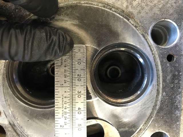

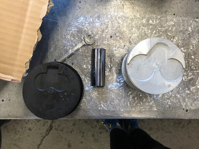

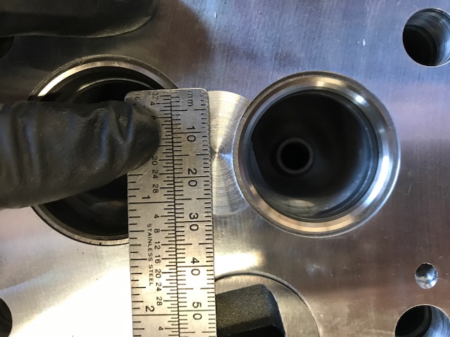

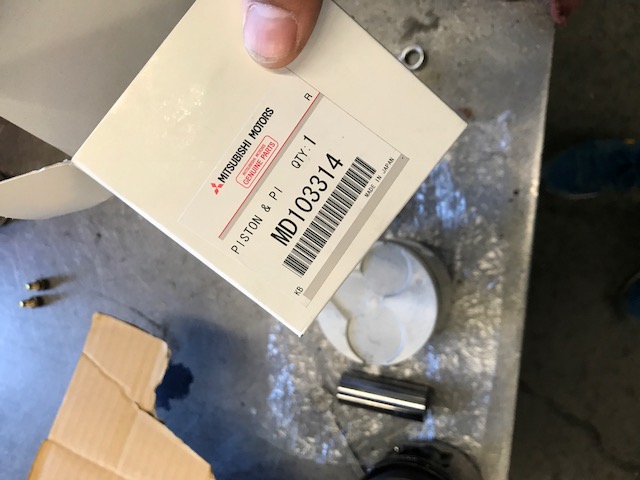

Hello everyone-
So, parts arrived yesterday, .50 overbore pistons rings etc. Took it to the shop and got some bad news...something is not making sense. I've ordered parts for the engine from Amayama, double checked against the PartSouq site, but the piston head is a completely different shape. Also the replacement head I've ordered has a smaller combustion chamber diameter, so now there is a concern that either the engine is not the correct one, or that the parts are not correct. That and the valve seat recession is different...so everything feels out of whack at the moment.
Pictures below show help tell the story.
What do you guys think? Did I basically get an engine that is not, in fact, from a 1991 Delica? Or is it just that there have been changes and updates over the years and these replacement parts are in fact going to work (I doubt it...)
Any help or input is appreciated :)
- 0.50 overbore piston for 1990 Delica

- Overbore versus the piston that came out of the original engine
- IMG_3240.JPG (107.93 KiB) Viewed 8681 times

- IMG_3239.JPG (102.79 KiB) Viewed 8681 times
- Combustion chamber from replacement head
- IMG_3238.JPG (85.7 KiB) Viewed 8681 times

Righto. Your new piston is a pre-'93 piston for use with a pre-'93 protruding valve head. The old piston is a post-'93 piston, for use with a recessed (also called flush) valve head. That old piston is not out of a '91 engine. If it was pulled from a '91 Delica, it's not the original engine.murdermitten wrote:the piston head is a completely different shape. Also the replacement head I've ordered has a smaller combustion chamber diameter,
Though you might get away with it after all: you'll have to install a valve to check, but it looks like the new head is a protruding valve head which is correct for your new pistons. (The precombustion chamber port is large and square. Recessed valve heads have a smaller, more rounded PCC port). I hope it came with valves though, recessed and protruding valves are not interchangeable (they're different lengths) so you can't use the valves from your old head.
Check out this post in the TRL: http://www.delica.ca/forum/viewtopic.php?f=94&t=17332
