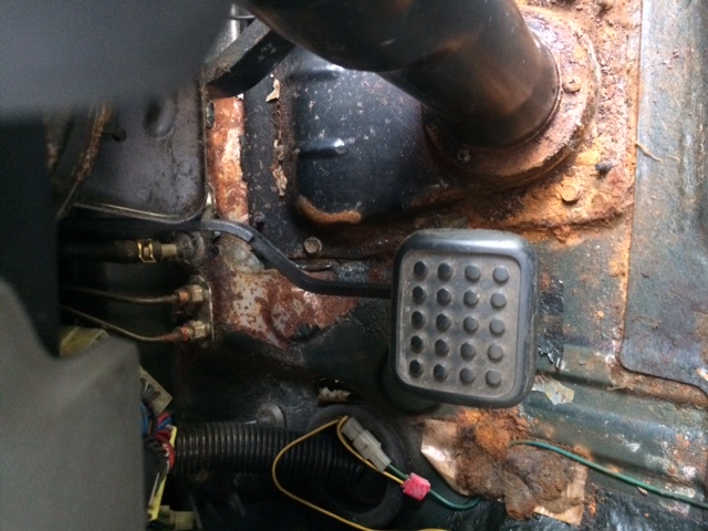

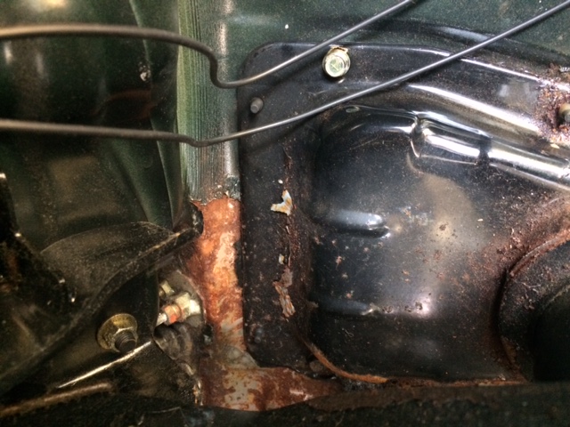

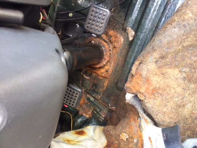

I've recently run into the Wet Foot syndrome. I lifted my carpet and found this....
When I get my cast off (two more weeks
) I'm taking off the quarter panels to check the seam that likes to leak. I hadn't thought of the headlights as being the source of the leak.

That's been leaking for a while. Gross. The headlamps aren't usually a source of leaks as they're entirely outside of the body. The only hole through the body is where the wires pass through, and that's fairly well shielded from rain runoff.

'That's been leaking for a while. Gross." Thats what I said when i saw it.
I guess the question is do you replace those rusted parts (which seems to involve taking out the steering assembly, or PORing the parts in place?

Your restraint is commendable: I would have said something far more colourful.Morgonzo wrote:'That's been leaking for a while. Gross." Thats what I said when i saw it.
I would get in there with a selection of wire brushes and clean as much up as possible, scrub down with simple green and rinse well. As long as nothing has actually rusted through, I would then prime with Brunox (or similar epoxy-based rust converter), then paint with POR15 or similar to seal it. Letting everything dry well between steps, of course- a fan heater on low or dehumidifier in the cab overnight will do the trick.
The way the paint's come off the seam sealer suggests the whole mess started with a brake or clutch fluid leak. I'd check that it's not leaking any more- no point applying new paint if it's just going to come off again. Also consider washing the carpet and underlay (or replacing the underlay): if they're soaked with brake fluid or impregnated with rust they'll just start the process again.

Morgonzo, I would pull your instrument cluster and check if your master cylinder is weeping. It was a main issue of mine for rust in the area of your photos.

Thanks for the tips and words of encouragement guys. I guess my big worry with painting a rust converter on was accidentally fusing the pieces together and being majorly boned when i actually do need to take that section apart (I don't know why i would have too...but I really try to not make more problems for myself while trying to solve the problem I DO have..tricky stuff
). I also agree that the way the paint was peeling off the metal seemed like a chemical reaction...not your normal water corrosion. I've been keeping an eye on the clutch/brake fluid res because i thought the clutch felt wonkey at times but i haven't seen it move. So it seems I have two leaks...one water (wet carpet) and one chemical. Again it'll be after April 7th before i can do anything about it
.... i'll just keep an eye on the brake/clutch fluid till then.

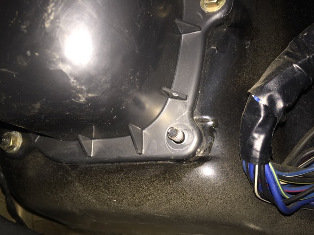

Just a quick update on my issue here. It turns out that the culprit is indeed the fresh air intake. I'm still not sure whether the headlamp change disturbed the seal, but the van is parked slightly downhill, meaning that the water from the top of the van and gutters runs down the front, into the headlight casing. In pulling up the carpet and poking around, I found that there is a leak in the corner of the intake duct (maybe a little hard to see in the picture). So even though it's a smallish leak, it seems like it's channelling enough water to be seriously problematic. Fortunately, no rust down there, so once I reseal that and dry it all out (and maybe drill an extra drainage hole as insurance), I should be good to go...*fingers crossed*.Growlerbearnz wrote:The only thing I can think of that you might have disturbed is the fresh air intake, which is behind the passenger side headlamp.
Thanks for the tip, Growlerbearnz!

Good catch! did you take off that missing nut or was it M.I.A upon inspection?phalteman wrote:Just a quick update on my issue here. It turns out that the culprit is indeed the fresh air intake. I'm still not sure whether the headlamp change disturbed the seal, but the van is parked slightly downhill, meaning that the water from the top of the van and gutters runs down the front, into the headlight casing. In pulling up the carpet and poking around, I found that there is a leak in the corner of the intake duct (maybe a little hard to see in the picture). So even though it's a smallish leak, it seems like it's channelling enough water to be seriously problematic. Fortunately, no rust down there, so once I reseal that and dry it all out (and maybe drill an extra drainage hole as insurance), I should be good to go...*fingers crossed*.Growlerbearnz wrote:The only thing I can think of that you might have disturbed is the fresh air intake, which is behind the passenger side headlamp.

That nut retains a metal plate in front of the air intake, it stops passengers from kicking the aircon tubes. You have to remove the plate to see the air intake, I'm guessing that's why the nut is absent in the photo.

Yes, GB is right - it's missing because I took off that plate in order to poke around.
