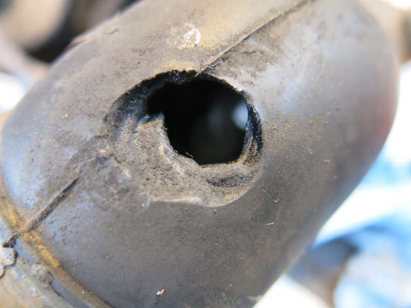

So I've opened up the driver's seat floorpan to replace this hose off the turbo which had developed a hole (and replace the rocker gasket and clean the area really well to pursue an oil leak diagnosis - but it's pretty obviously the half-moon seal) .. any thoughts on what may have caused the hole? looks like a burn, my mechanic said maybe a mouse chewing?

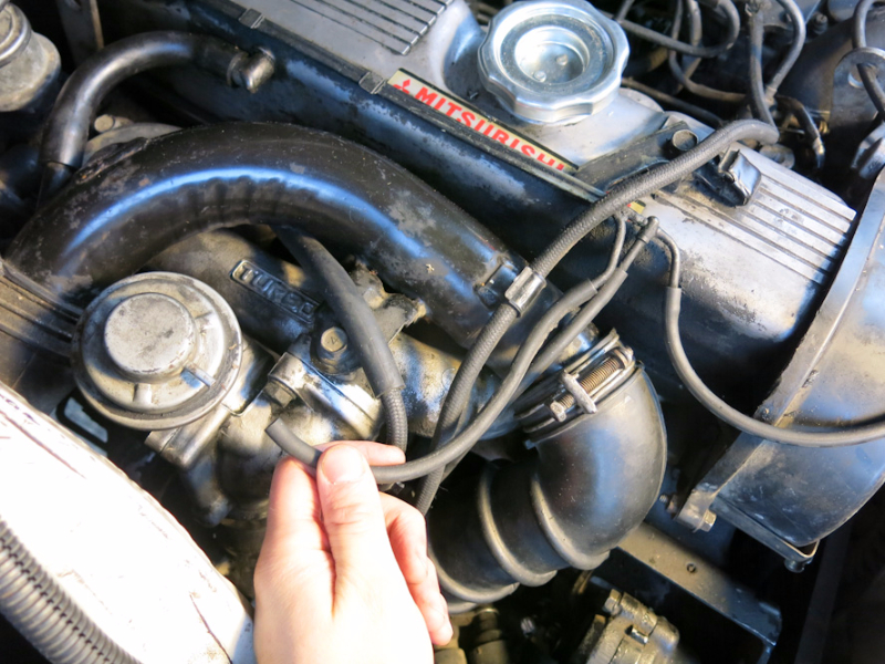

I also noticed that this breather hose off the rocker cover was loose that attaches to the top of the turbo ... just wondering if there is any reason to leave this loose or if it simply must've fallen loose?

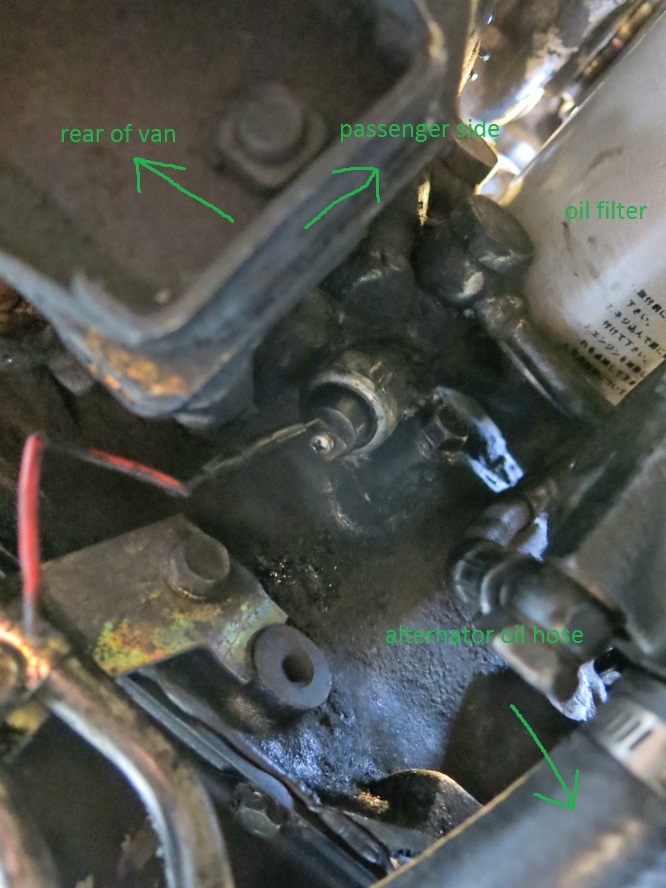

I've also been wondering about this loose wire near the alternator - under the oil filter? what is it?

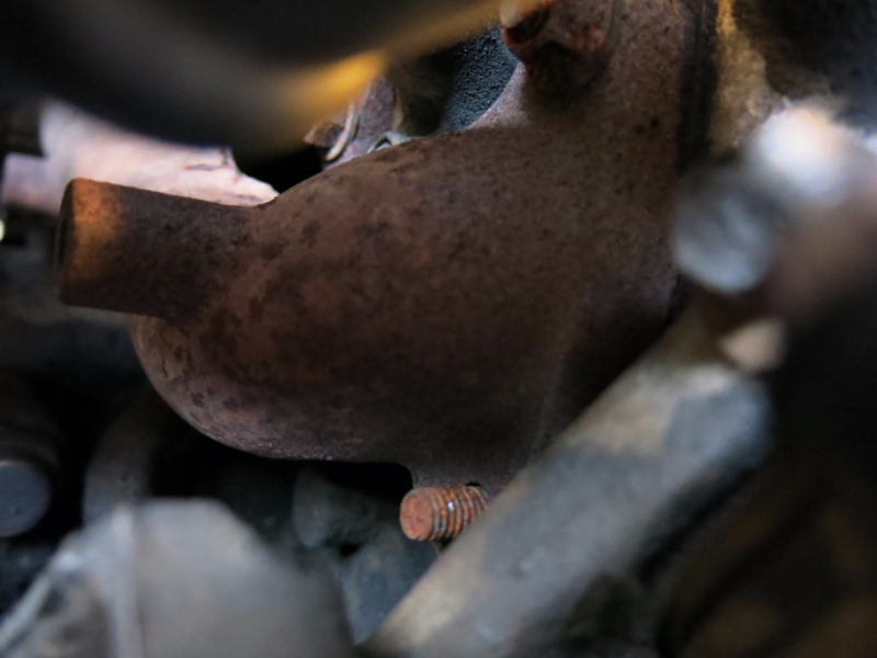

and is this an acceptable condition of the manifold under the turbo? I'm assuming this has something to do with coolant judging from the rust!
I got a few spots of coolant at the back of the engine right where the head meets the block and ... just trying to figure where it may have come from at the rear of the engine ...

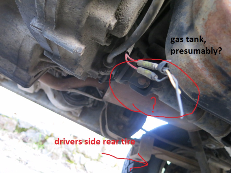

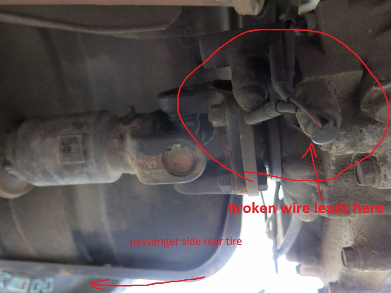

I also have a loose wire at the back of the van just infront of the rear axle.
Also a pic looking from the other side where the wire leads - near the rear U-joint I presume?

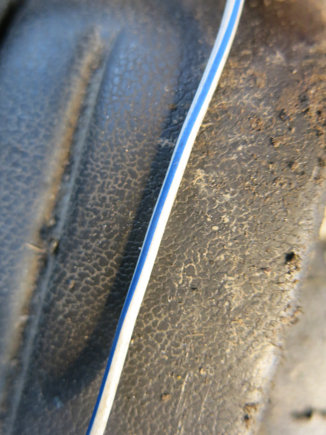

and one final thing - could take some better pics but I got tools all over the floormat right now, but this white/blue wire comes from the back of the van along the outside edge of the driver's seat and leads to the area to the right of the accelerator (near fusebox) before being cut off and the previous owner has sealed the end with heat shrink ... any thoughts on what it may be?

This is your 4wd sensor. A very common wire to come loose attributed to its loose placement under the van. I just reattached mine a few weeks ago with new connectors. There are many threads on the subject.sealica wrote:I also have a loose wire at the back of the van just infront of the rear axle.turbo-6.jpg

Intake hose hole looks like it has rubbed through. Look for a misaligned bolt or clamp that would be rubbing on that spot.
The vacuum pipe you’re holding controls the Exhaust Gas Recirculation (an emissions control thing). The cannister you’re about to plug the hose into is the EGR vacuum servo. It should be plugged in.
The red wire dangling below your oil filter is your oil pressure warning light. It’s a good idea to reconnect it. The rest of the wire should be in the loom that runs to the alternator. (The oil pressure light should illuminate when you turn the ignition on, before the engine starts).
Your exhaust manifold is perfectly normal. Repeated cooling and heating will cause surface rust, and there’s nothing you can do about it. The missing nut is a worry though- a loose manifold will damage the gasket, which is also your intake gasket. I’d check all the manifold flanges for more missing nuts. A loose *intake* manifold will allow oily pressurised air to blow all over the engine, which might explain some of the oil you’re finding. Replace the nuts with genuine Mitsubishi ones- they’re specially shaped to be self-locking even when repeatedly heated and cooled.
As North54 says, the red wires are your 4WD sensors (which turn on the 4WD and Low Range lights on the dashboard). The rest of those wires should be in the wiring loom that runs over the front fuel tank and onto the transmission.
The white/blue wire isn’t factory. I’d guess it was originally a power feed for some aftermarket accessory, maybe a reversing camera if it comes from the back?

The exhaust manifold! It definitely looks like it *may* be leaking oil from the area surrounding the missing bolt. I got my valve cover gasket on and cleaned everything as much as possible, but I'm going to wait 24h to start the engine/allow sealant a full cure (also need to replace the driver's seat and do a final inspection to make sure I don't have any leftover assembly to complete). I found some nuts/washers for the manifold thru amayama, but shipping is pretty high for $3 in items - so trying to find some other things I need to round out a shipment :p

There should be two fat white wires going to the alternator output bolt (under a red rubber cap) but also a couple of thinner wires going to a plastic plug that's also on the back of the alternator. The oil pressure wire follows the two (or three) thinner wires.sealica wrote: just two pretty thick ones going right to the alternator.

-I'm pretty sure the wire coming from the loom above the alternator is broken off so far that it's kind of asking for trouble to dismantle the functioning loom. I was wondering if it's possible to just bypass the loom and rewire the oil pressure sensor directly with new wire?

I'd still try and find the original oil pressure wire in that loom. Even if you replace the wire entirely you're going to have to connect it to the loom somewhere, it might as well be where it's supposed to be. If you were to run an entirely new wire, it would be connected to a plain yellow wire on the back of the instrument cluster. Watch out though, the fuel gauge wire is also yellow. Test first before cutting.
