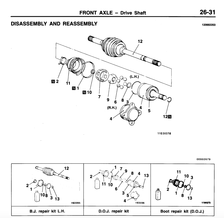

Could be a bad bearing in your BJ assembly. My 4wd feels a little rough and I'll be checking these bearings.
They are 7,9,6 in the pic. One big holder and several loose balls.

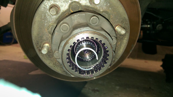

Chapter 26 (front axle) page 27 shows the bit you need to unscrew (the illustration hilariously implies you can unscrew the chromed cap with your fingers) and the next picture shows removal of the snap ring, which will let you know what you're looking for.
I wouldn't worry about renewing the grease. You'll need to remove/move some temporarily to be able to see the snap ring, but if you use a bit of clingfilm it should stay clean enough that you can put it back when you're done.
Here's what it looks like behind that cover after you've scooped the grease out- in this picture the circlip is removed (duh) but it should be attached to the axle- the innnermost splined part. If it's floating free (though covered with grease) then you've found your problem.
