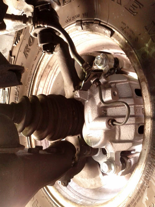

I think I left the top and middle brackets alone and modified (AKA: bent) the short steel pipe to bring the lower bracket back to approximately where it was on the single piston caliper.
Hang on , I've got a picture around here somewhere:

Very nice! I was just wondering about that alternate bracket placement. Good to know it worked for you and hopefully it give my longer braided line the clearance it needs.

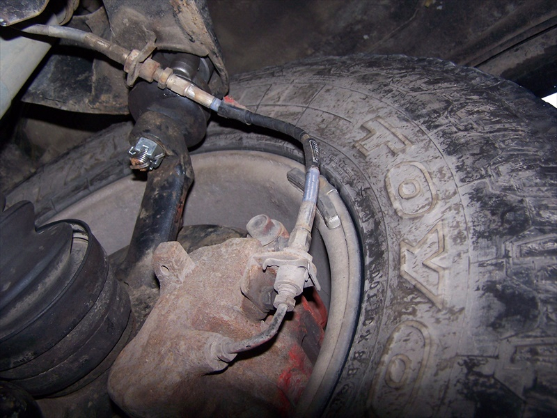

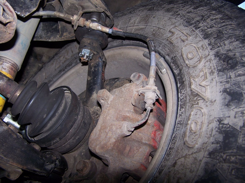

Growlers picture looks a little different than I remember so I took a couple of pictures this morning. Your situation sounds similar but worse than mine. The braided hoses are a little longer than necessary and mine rubbed on the wheel if I was going around a corner and put on the brakes. The dino evo install uses a bracket to keep the hose further from the wheel. I loosed the existing bracket and turned it to the inside.It seems to have worked. I put tape on the hose to see if it still rubbed and the tape is still there after a few thousand KM so I guess it worked. Good luck with the rest of your install, I'm sure you'll be impressed with the results especially on long downhill runs.

Ah! I remember now. My new calipers didn't come with the short steel line, I re-used the (longer) one off the old calipers.
I wonder if you could re-angle the bracket and steel pipe on the caliper to aim the flex hose away from the tyre?
