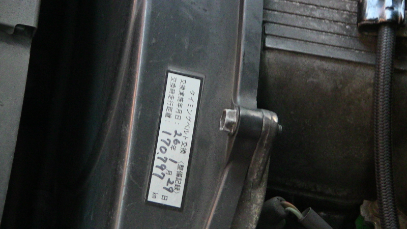

One more question I wanted to ask, there is a smallish silver sticker on the black timing belt cover. It has 170,797 written on it. I'm cautiously hoping that the sticker means that my timing and balancing belts were done right before I got the van. I'm going to try to post a picture..

Although I do not read (or speak) Japanese, I would presume that the top numbers 26, 1 & 29 are a reference to a date ('though I'm not making sense of the numbers without understanding the ideograms amid them) and the bottom six numbers (170,797) are referring to the kilometres on the odometer when the job was last done, in Japan. How many kilometres are on your wagon now? Are there anymore stickers nearby that have a reference to the T belt (such as six numbers &c..)?
Cavitation risks with the 4D56?
Clearly the belt was changed on Imperial Era Heisei-26, January 29th. That's 2014/01/29 to you westerners.
(Ok, so I just learned something about date and time notation in Japan: https://en.wikipedia.org/wiki/Date_and_ ... n_in_Japan)

Thanks for the reply Falco and Growlerbearnz! I currently have 173,680K on the clock so it must not have been driven very much after the belt change..Great News! :-D Growlerbearnz, I really appreciate you taking the time to de-code the Japanese characters for me. Thanks. I've been trying to answer all my questions using the manuals but it gets confusing at times :-) I do have another question, what is your process for changing the fuel filter? do you have to take off the the fuel lines from the filter head to get to the water separator? It's my last filter to changeand I wanted to ask before i dove into the job. It does not seem to have enough clearance to get the new filter in with those lines in place.
