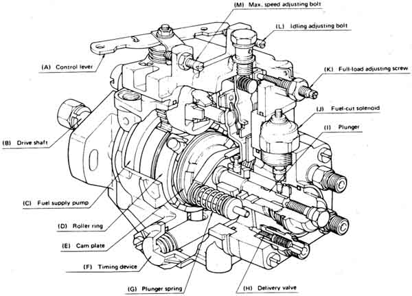

Since it's intermittent, my first guess would be a failing injector. A diesel or fuel injection shop (there are a few in Boston, and it looks like South Shore Diesel in south Middleborough) should be able to test the injectors and rebuild them if needed. They'll need to be removed from the engine to be tested.
It might also be the injection pump. The advance plunger can stick which causes it to inject at the wrong time, giving the symptoms you're describing, but the injectors are cheaper and easier to check first. If you end up needing a rebuilt injection pump you're going to want rebuilt injectors anyway, so you might as well start there.

If I end up needing an injection pump rebuild /replacement is there a how to online that can step me through removal /reinstall? Also I'm assuming the pump is nothing crazy and is like any other rotary injection pump, meaning it should be rebuildable by any competent diesel shop. Any online specs for the pump?

Also, if the advance plunger is sticky, can it be fixed with any sort of additive in the fuel, or is it only repairable with a teardown? I'm leaning towards the advance plunger because it doesn't act funny at idle, and only makes noise when revving.

If the advance plunger is sticking you *might* free it up with some kind of additive, but I wouldn't expect the fix to last. The advance plunger lives at the bottom of the injection pump, so any cruft tends to collect there. The advance plunger cover plate is also a source of fuel leaks, and I've seen one or two that have been sealed with silicone (rather than just replacing the O-ring). The silicone gets into the plunger mechanism and you have to rebuild the injection pump. Look for leaks or sealant on the cover marked "timing device" in this picture:
