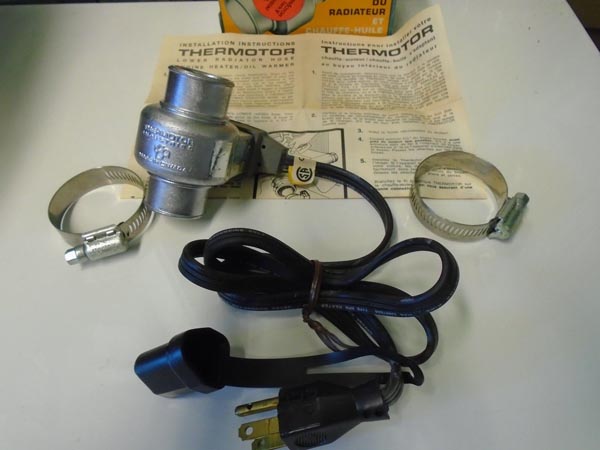

Intake air heaters are more reliable than glow plugs (only one thing to break rather than four, lives in the air intake not in the combustion chamber), but they can take a little longer to warm up, and aren't usually as good at starting the engine or helping it run smoothly when it's cold. Intake heaters tend to be found on more industrial engines, and Landcruisers because Toyota.
The few water heaters I've seen were inserted in the lower radiator hose or a heater hose, and when they heat the water it just circulates by thermosyphon (hot water rises, pushing cold water through the engine).
Here's a picture of one from Ebay:
