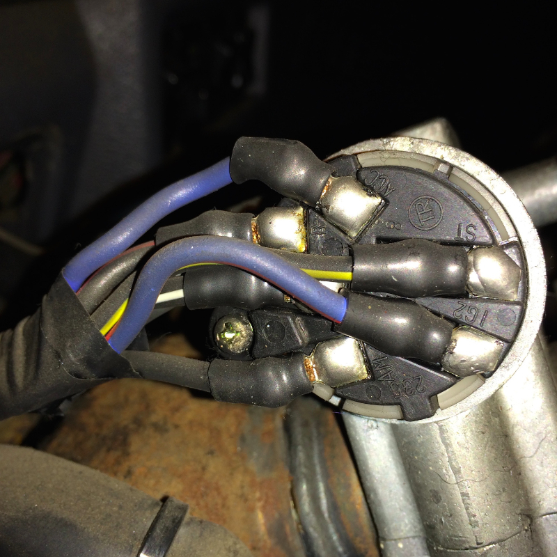

OK, so I finally dug into this.
Apparently my wires a bit different!
Anyone know what these colors could correspond to?
1) Black
2) *Black* with white stripe
3) Black with red stripe
4) Black with yellow stripe
5) Blue
6) Blue with red stripe
7) more smaller ones...
Picture1:
File Sep 07, 11 46 50 PM smaller.jpeg (620.79 KiB) Viewed 6390 times
Picture 2: (you can see the spliced wires.. not sure what these are yet)
File Sep 07, 11 45 57 PM smaller.jpeg (593.6 KiB) Viewed 6390 times

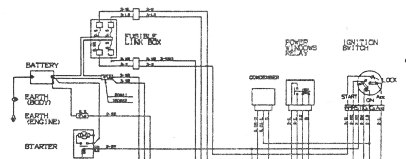

And this is from DinoEvo's 1990 L300 (europe) wiring diagram:
Screen Shot 2016-09-07 at 11.45.08 PM.png (153.82 KiB) Viewed 6390 times
