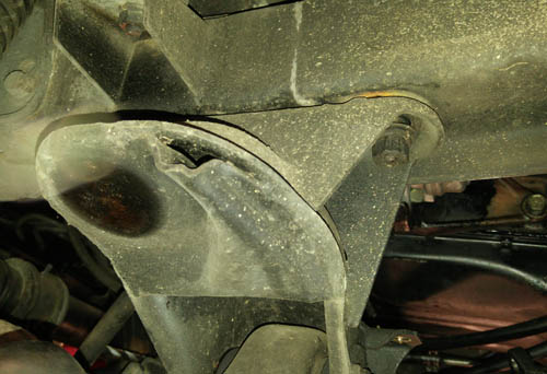

The bolts that hold the front subframes to the chassis are notorious for causing a single "clunk".
There are two on the rear subframe (the one that holds the front axle) near the bump stop:
...and another two larger bolts on the front subframe (the tubular one that holds the steering rack).
You say you've checked the wishbone bushes, but just make sure the bolts are nice and tight. The cam plates can move around if the bolts aren't tight enough.
