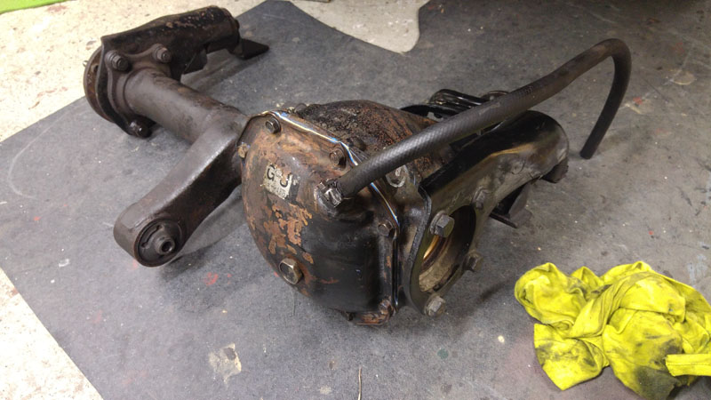

Remove the front differential from the van. http://www.delica.ca/forum/viewtopic.php?f=96&t=17677

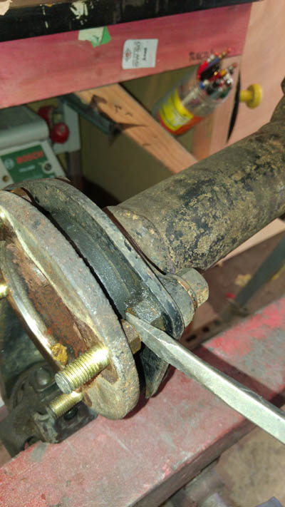

Take off the diff cover and extract the axle shaft. The workshop manual recommends a slide hammer, but you can also just lever here and tap it with a regular engineers hammer and it'll pop right out. Sometimes the circlip pops out of its groove and won't let you remove the axle- you can push the circlip back into place from inside the differential carrier.

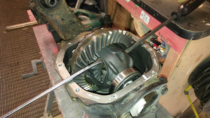

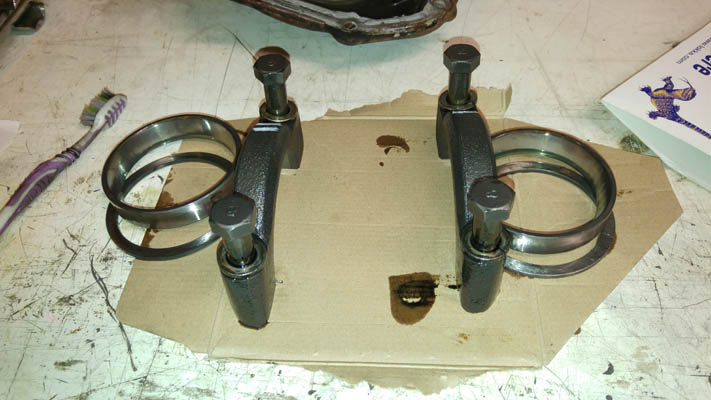

Mark the bearing caps so you can replace them in the same positions. Undo the bolts and remove the bearing caps, then lever the diff carrier out. **watch for the bearing races and shims- keep them on the side they came from so you can reassemble everything in the same place**

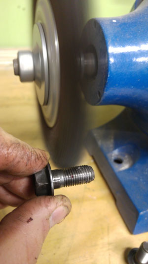

Mark the ring gear, then undo the bolts and remove the ring gear. **When reinstalling, you'll need to clean the threads with an M10 x 1.25 tap, and apply thread lock liquid- stud lock (the strongest) is what Mitsubishi specify.**

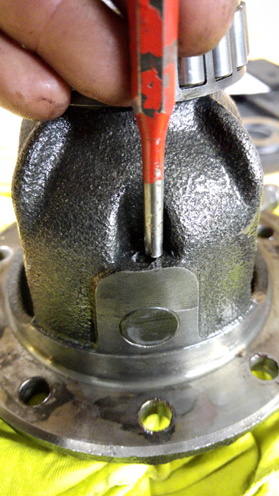

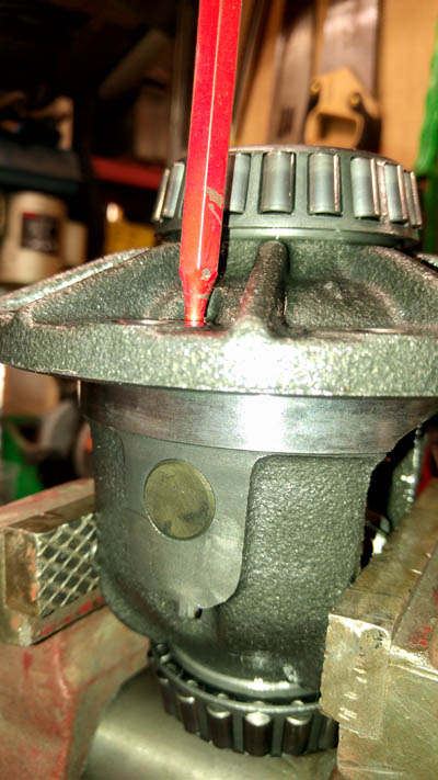

Using a drift (or a dead drill bit, if you're a bit dodgy), remove the lock pin (it only comes out one way) and the cross pin. (It's a good idea to use soft jaws to protect the diff carrier and vice, but I didn't because reasons.)

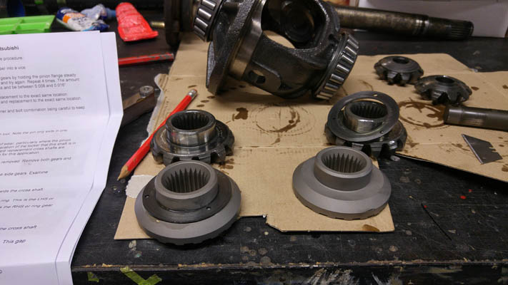

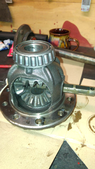

Rotate the side gears to remove them, then remove the axle gears. **keep the axle gear shims on their original sides**

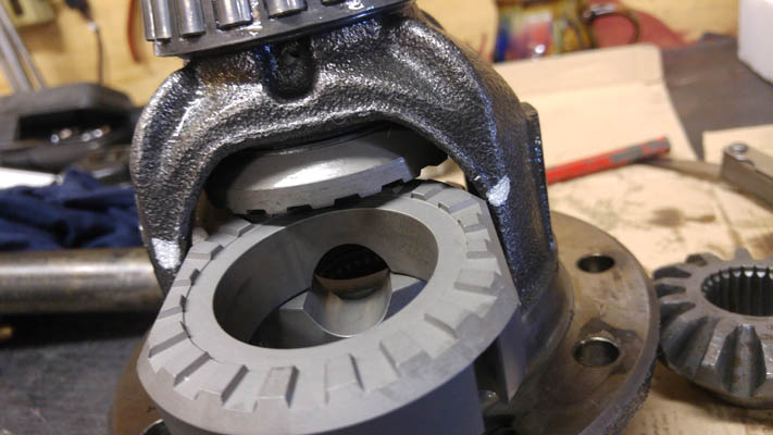

Now follow the instructions that came with your Lokka. On mine, they refer to the short axle gear going on the "long axle side, with no snap ring"- this may be confusing, as both the long axle and short axle/CVs have a snap ring: Lokka have confirmed that the short axle gear goes on the long axle, and that they were trying to imply that the snap ring is optional.

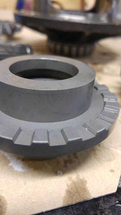

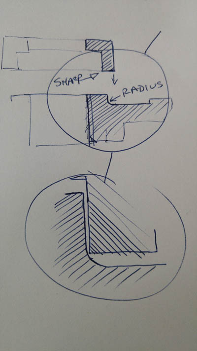

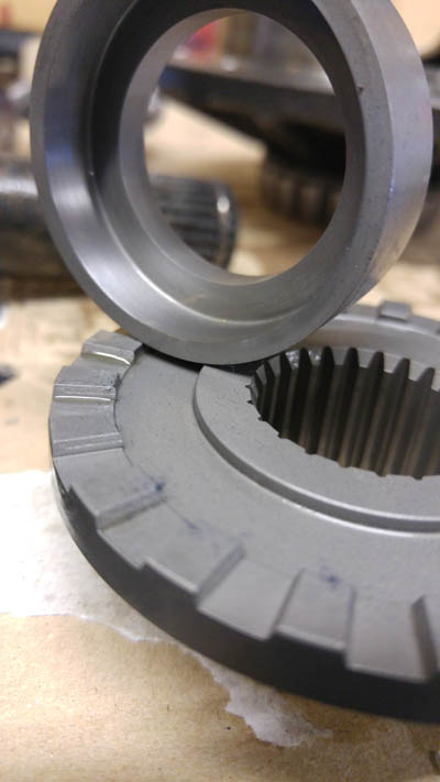

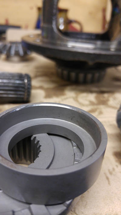

The spacers that came with my Lokka had a sharp edge on the inside that interfered with the radius edge on the axle gears, making it impossible to install the cross pin. I've told Lokka about this, and they say they're looking into it.
I ground off the sharp edge so the spacers would sit flat (a die grinder or Dremel will do), and it all went together properly.
Finally, install the cam gears and measure the distance between cams.
My side gear shims were super tight, and my clearances were too tight for the range the Lokka requires. My shims need to be 0.35mm thinner to bring everything into the middle of the range. I'm going to have to order a shim kit- I really should have done that first, because pulling the axle is a pain.

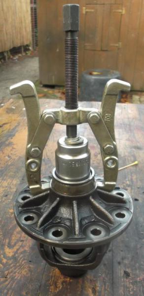

Was it a PITA to get your bearings off the carrier?
Re: L300 Lokka install: work in progress.
I use a 2-prong bearing/gear puller to remove the bearings, with the tips of the puller ground down to fit into the small space under the bearings, kind of like this:
W201 differential removal of axial shaft bearing races3.jpg (28.06 KiB) Viewed 14626 times

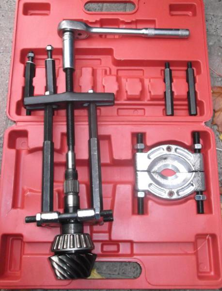

Damn! I grabbed that picture from Google as an example, but it's exactly the sort of dodgy setup I use. There's actually a proper tool available, which I really should buy someday:
W201_018 using bearing puller to remove ABS tooth in differential.jpg (41.72 KiB) Viewed 14626 times

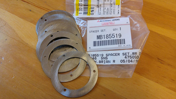

Previously I'd run into issues with the clearances- without a shim kit it was going to be irritating to get the clearances right. But now I have a shim kit...
Part number MB185519. The shims in my kit are 0.80mm, 0.86, 0.90, 0.93, 1.00, 1.06, 1.10, 1.13, 1.16, 1.22, 1.27, 1.33. I'm going to have to use the two thinnest ones- I guess the kit is for bringing a worn differential back into spec.

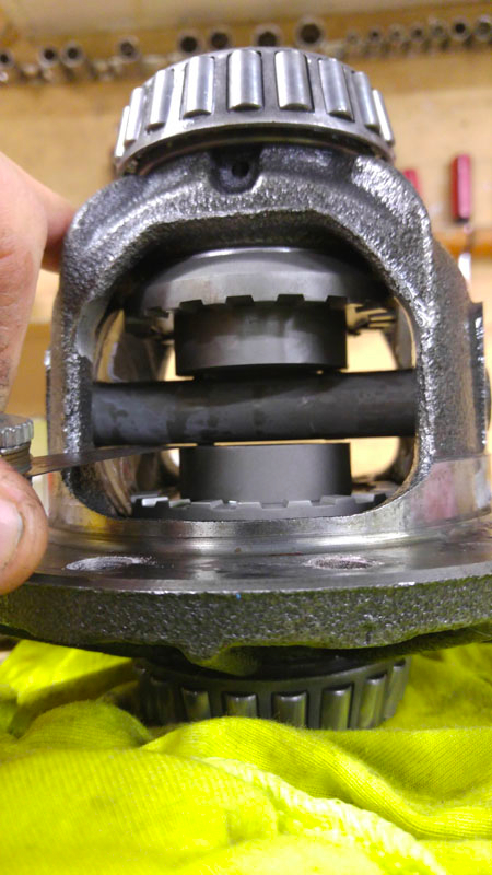

Install the side gears and spacers with new shims, then the cross shaft. Check the clearance between the cross shaft and the spacer- it should be 0.006 - 0.020", and ideally even on each side. (Mine are 0.012"). Lokka say not to worry too much about these clearances, the important one is the inter-cam clearance which we measure later.

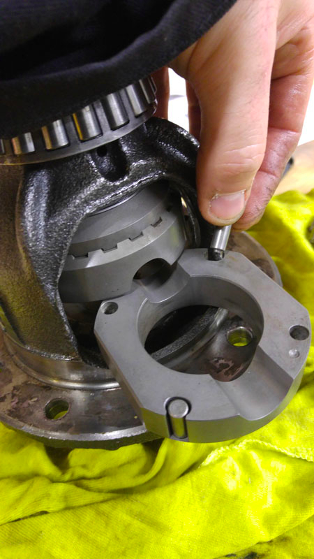

Now install the pins into the open slots in the cam gears, with the nipple on the pin downwards. The nipple will sit inside the spring when we get to those.

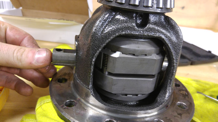

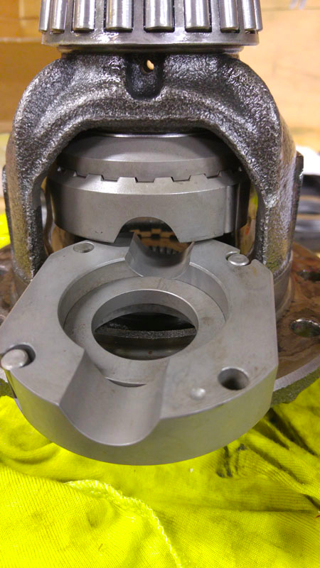

Install the cams into the diff cage. The upper one goes in first, then slide the second one in with the spacer inside.

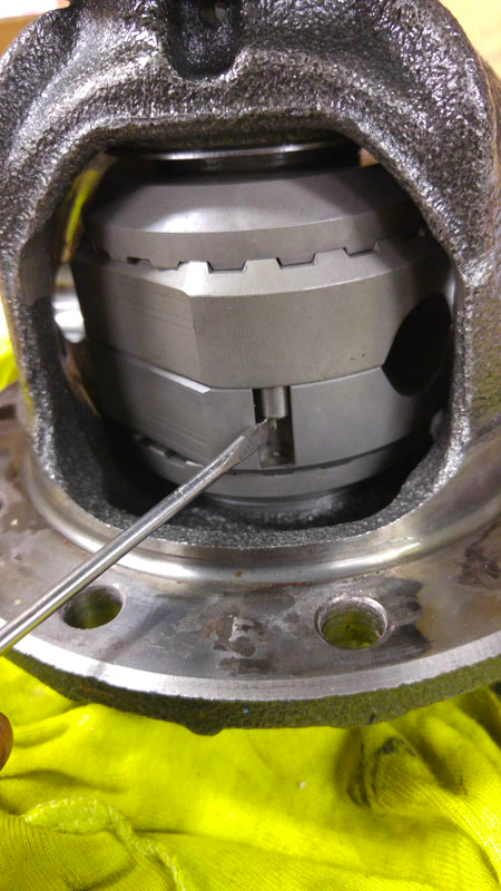

Align the cams, then push the pins across into the opposing hole.

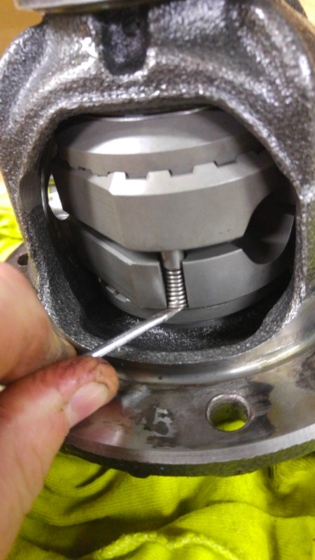

Wear safety glasses. Install the springs. Be glad you're wearing safety glasses as the last spring bounces off where your eyeball would be. Spend half an hour looking for the spring. Find it lodged in your beard. Install the last spring.

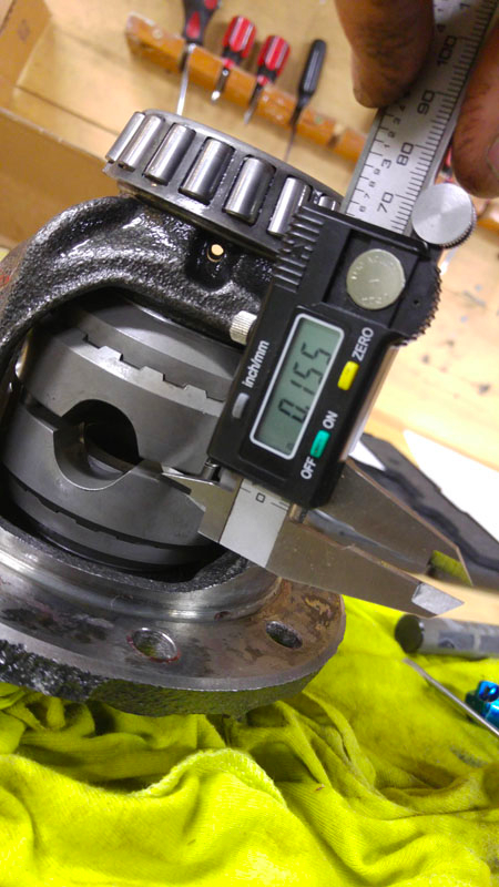

Push the cross shaft into place, and check the clearance between cams. It should be between 0.145 - 0.165". Nailed it.
Install the locking pin and peen the edge of the hole so it can't come out

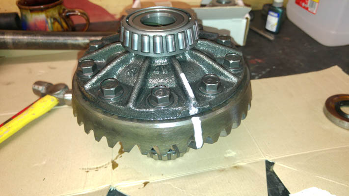

Clean up the ring gear bolt holes and bolts (M10x1.25 tap), and install with thread locking compound (usually red).
Reinstall the differential into the housing, making sure you put the spacers and bearing caps back the way they came out.

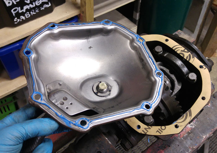

I prefer to use a paper gasket and a small amount of sealant, but some people just use form-a-gasket. Those people are heathens and I'm totally judging them.
