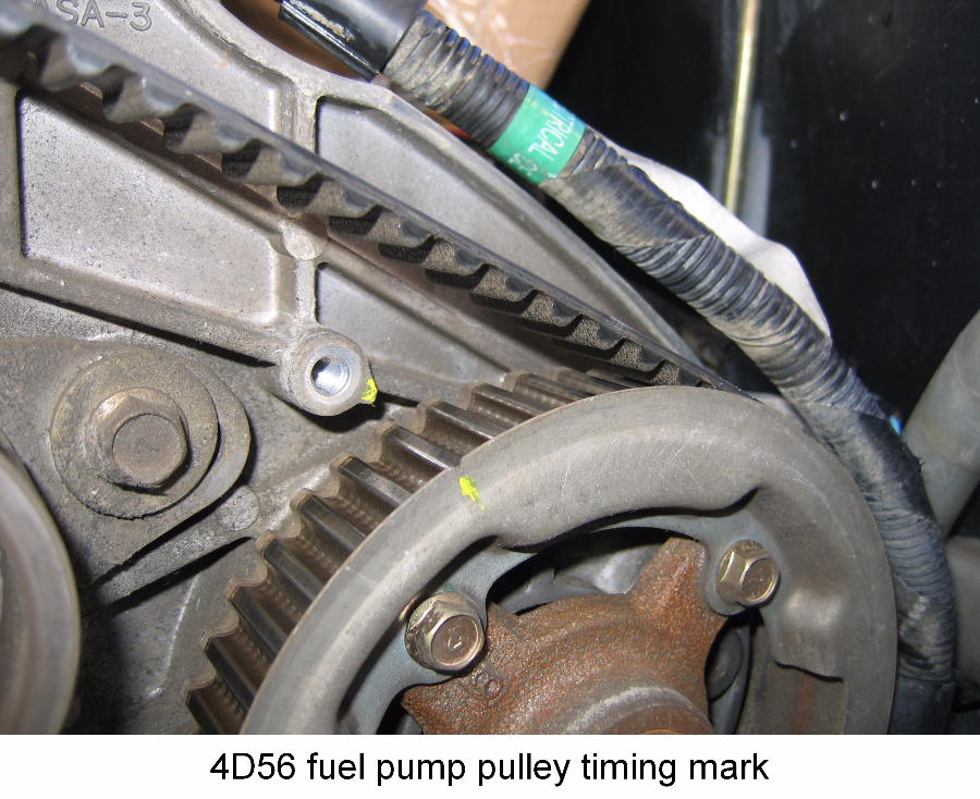

If the clattery tractor noise happens at idle as well as at speed, then I'd say it sounds more like your timing belt might have slipped a tooth. Sometimes this happens because the tensioner is loose (but I'd expect it to slip more teeth on a 100 mile drive), sometimes it's because your balance belt breaks, knocks the timing belt off a tooth, and then settles into the bottom of the timing cover to sulk (until you drive over a big bump and it comes out to play again.) The oil consumption can be because of the extra pressure in the engine from the fuel being injected at the wrong time- the same thing that causes the rattly noise.
Before removing the turbo (a pig of a job), I'd remove the top timing cover and have a look around inside with a flashlight for any spare bits of balance belt. If you don't see any, turn the engine until the cam and fuel injection pump pulleys point to their respective timing marks, then look for the timing marks on the lower plastic belt cover- the crank pulley notch should be pointing at the leftmost "T" mark on the belt cover. If any of the timing marks are misaligned you've slipped a tooth.
4d56 timing marks 02.jpg (871.85 KiB) Viewed 4276 times

Man! Thank you for this info! I'll tear into it this weekend and find out for sure. The more I think of it, the more your idea seems right. It was on a particularly hard downshift when it happened, and as I believe, all the belts are relatively new and might need to be tensioned. fingers crossed.

Thank you immensely for the post about skipping teeth on the timing belt. That was the exact problem. I lined everything up,followed your instructions, and fixed the problem without trouble. You've saved me from so much stress and wasted time.
Re: Black smoke, loud noises, low power... Is my turbo bad?
Awesome! Glad you're back on the road. And thank you for letting us know how it worked out- it'll help anyone in the future with a similar problem.
