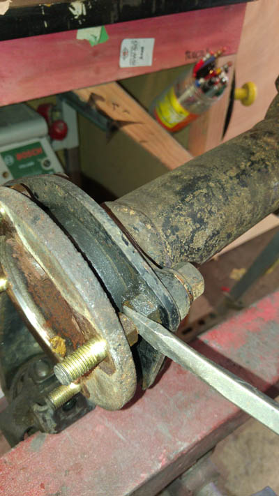

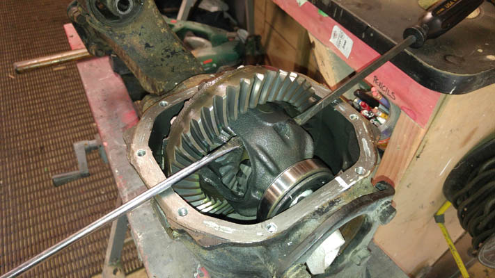

Take off the diff cover and extract the axle shaft. The workshop manual recommends a slide hammer, but you can also just lever here and tap it with a regular engineers hammer and it'll pop right out.

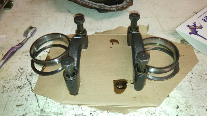

Mark the bearing caps so you can replace them in the same positions. Undo the bolts and remove the bearing caps, then lever the diff carrier out. **watch for the bearing races and shims- keep them on the side they came from so you can reassemble everything in the same place**

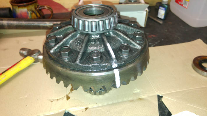

Mark the ring gear, then undo the bolts and remove the ring gear. **When reinstalling, you'll need to clean the threads with an M10 x 1.25 tap, and apply thread lock liquid- stud lock (the strongest) is what Mitsubishi specify.**

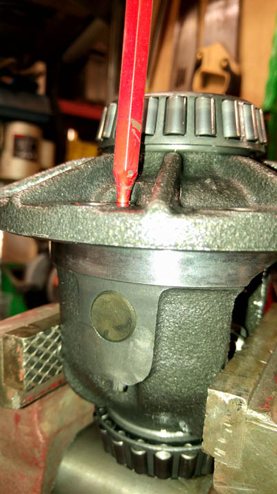

Using a drift (or a dead drill bit, if you're a bit dodgy), remove the lock pin (it only comes out one way) and the cross pin. (It's a good idea to use soft jaws to protect the diff carrier and vice, but I didn't because reasons.)

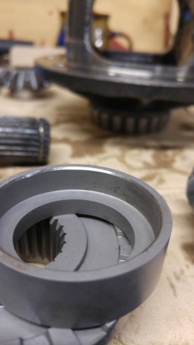

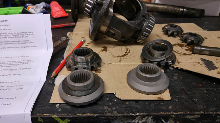

Now follow the instructions that came with your Lokka. On mine, they refer to the short axle gear going on the "long axle side, with no snap ring"- this is confusing, as both the long axle and short axle/CVs have a snap ring: Lokka have confirmed that the short axle gear goes on the long axle, and that they were trying to imply that the snap ring is optional.

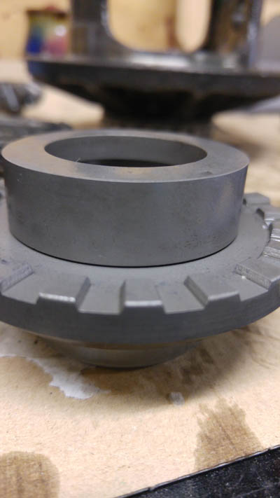

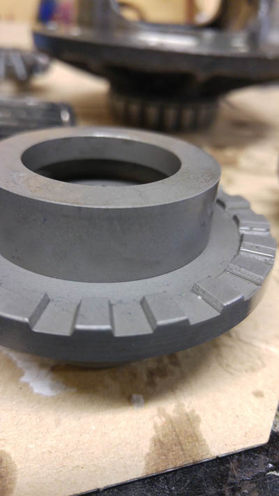

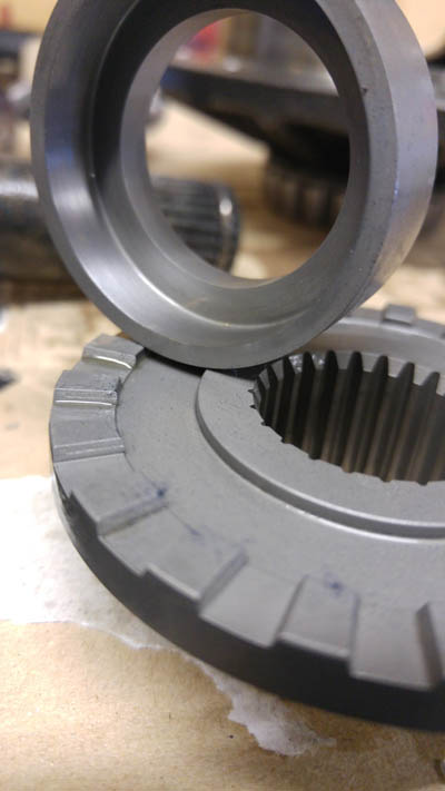

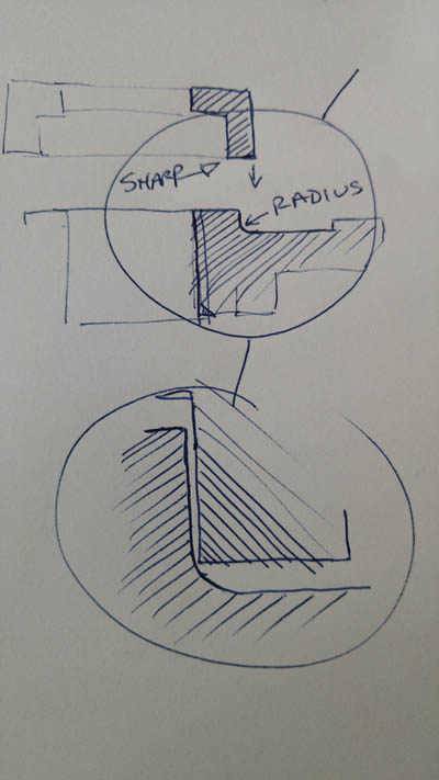

The spacers that came with my Lokka had a sharp edge on the inside that interfered with the radius edge on the axle gears, making it impossible to install the cross pin. I've told Lokka about this, and they're looking into it.
I ground off the sharp edge so the spacers would sit flat (a die grinder or Dremel will do), and it all went together properly.

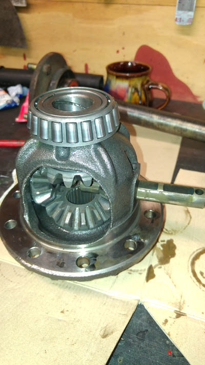

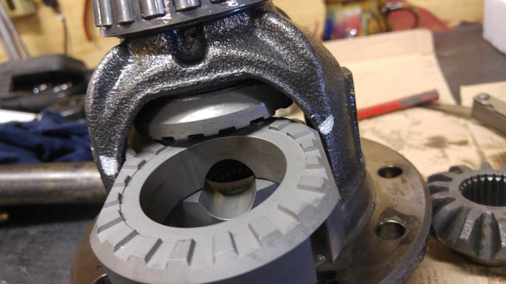

Finally, installing the last cam gear can be tricky due to differences in the carrier casting- it appears this is common with any locker install. I had to grind a tiny bit off the carrier where it's marked:

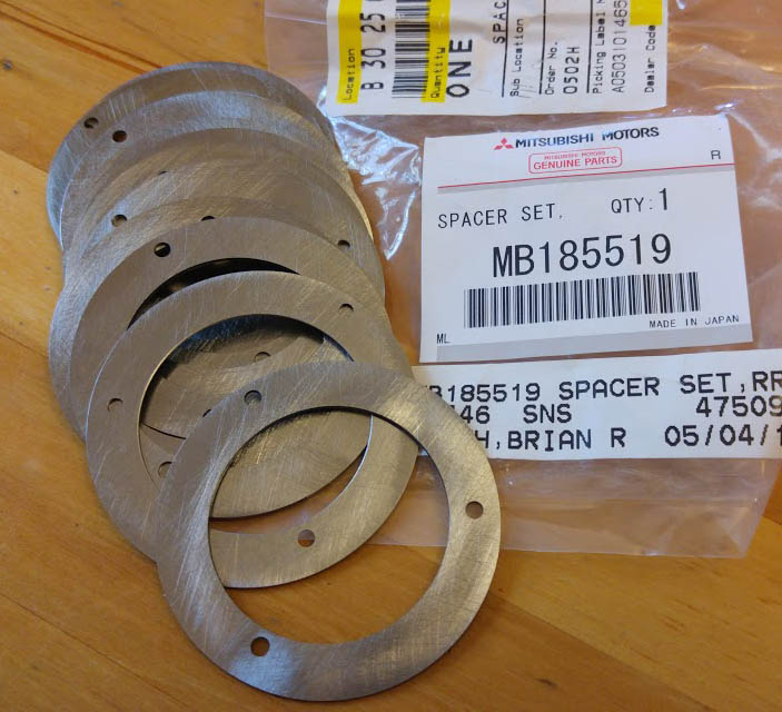

This is still a work in progress: my side gear shims were super tight, and my clearances were too tight for the range the Lokka requires. My shims need to be 0.35mm thinner to bring everything into the middle of the range. The shims are very hard, so I'm trying to find a shim kit. Failing that I'll have them machined down by an engineer with a magnetic chuck.

My diff side gear shim kit finally arrived! Part number MB185519, about $60 (ouch).
For reference, the pack has shim sizes; 0.80mm, 0.86, 0.90, 0.93, 1.00, 1.06, 1.10, 1.13, 1.16, 1.22, 1.27, 1.33mm.
Also in the package from Japan: new bearings, seals, and cross pin.

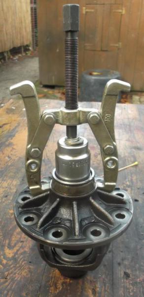

Thank you! That exact thought, and was going to measure before I pulled it all apart. Was it a PITA to get your bearings off the carrier?
Re: L300 Lokka install: work in progress.

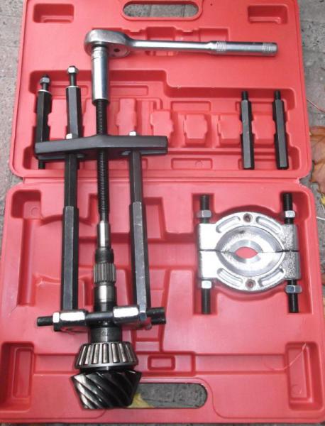

I use a 2-prong bearing/gear puller to remove the bearings, with the tips of the puller ground down to fit into the small space under the bearings, kind of like this:
W201 differential removal of axial shaft bearing races3.jpg (28.06 KiB) Viewed 12806 times
Damn! I grabbed that picture from Google as an example, but it's exactly the sort of dodgy setup I use. There's actually a proper tool available, which I really should buy someday:
W201_018 using bearing puller to remove ABS tooth in differential.jpg (41.72 KiB) Viewed 12806 times
