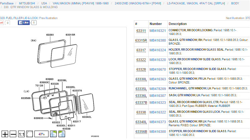

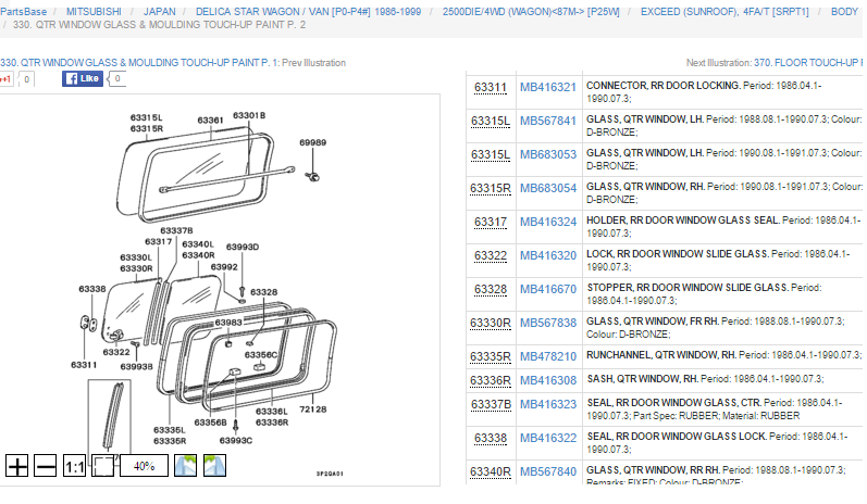

So someone smashed in my driver's side front sliding window and I'm looking to replace it. I've talked to a glass shop here in Oregon and they are saying that the US stock of Mitsubishi "Van"s where the sliding door is on the drivers side is not compatible with my Delica. Is this true?
I would understand not being able to switch the frame and windows from one side to the other because of the orientation of the screws and clips at the very least, but does anyone know if the sliding door window of a US van would fit the front driver' side slider of a Delica?

Please checked at Partbase.org and confirm but some Van did indeed have the same front window as the L300 (http://www.partsbase.org/mitsubishi/van ... glass-p-2/)
MB421412
Keep us in touch about how it turned out, it may help others.

Talked to Coombs and also checked out Partsbase. They are the same. However talking with an auto glass shop they don't manufacture anything but engine parts for the old US vans. No luck with wrecking yards as the only van is down outside of Los Angeles with no interest in shipping.
Anyone have a slider laying around?
