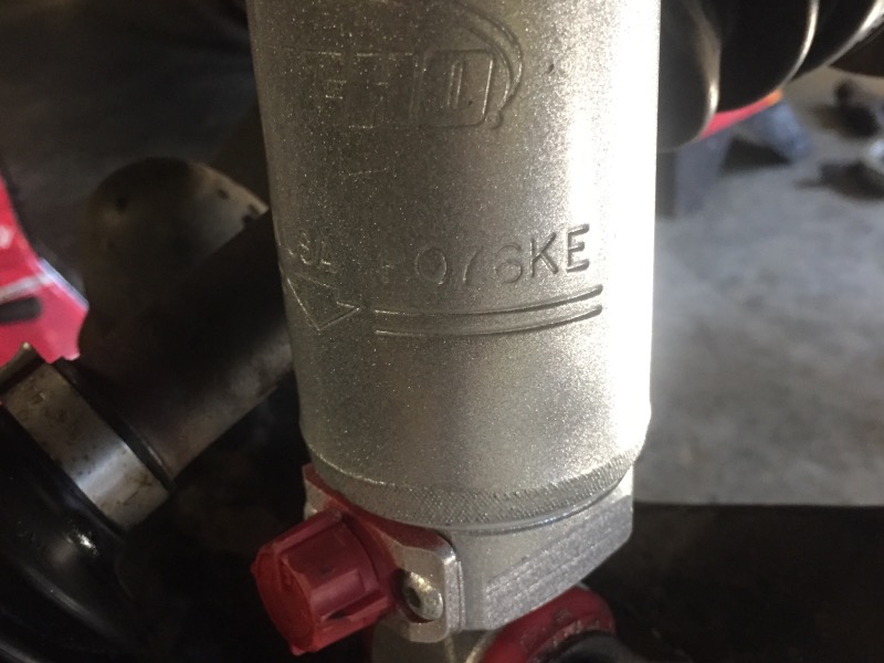

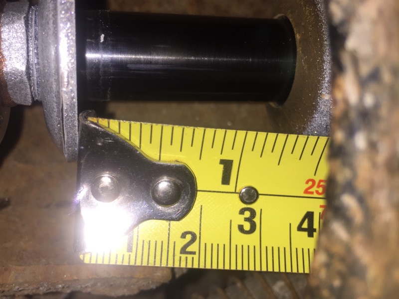

Re: 2"lift and no idea whitch part #????
Hi
I got spacers and springs. Awesome service!
Still don't know how these shock will work. With suspension fully extended all im left with is 1 3/4 travel.
Unless there is something im missing there is no way I can use these shocks on my l400 delica.
Anyone have any suggestions?
Marco
Marco
- Posts: 6
- Joined: Sat Mar 19, 2016 4:24 am
- Vehicle: Mitsubishi delica spacegear
- Location: Ontario Canada
Here are some pics
- image.jpeg (97.08 KiB) Viewed 8987 times
- image.jpeg (114.93 KiB) Viewed 8987 times
how much travel do you need?
M
Have a qualified mechanic do a shock travel measurement for your back and front shocks. It's possible you purchased the incorrect length shocks. The pictures don't show enough detail and information.
MD
MD
