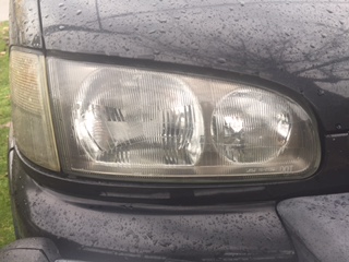

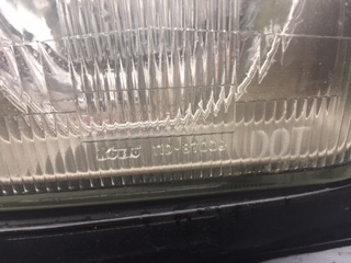

I recently bought a first generation L400 97 Delica from a dealer and it has DOT on inside of headlight. There is no E code on this headlight. Is this a illegal headlight for BC? I was informed by someone that it is not legal? That Delica never had dot headlights from Japan. Have I been scammed by the dealer?

ChrisinBc, have a look at this link. It has a ton of info on headlights and how to decipher the markings.
Its hard to see all the markings in your pic.

Re: Are my headlights legal in bc
I think Chris' issue is that the headlamps *dont* have E-codes. I believe Canada recognises DOT (US-market) headlamps, though it's curious that Koito (A Japanese OEM manufacturer) would make DOT headlamps for a vehicle never sold in USA.
It's even more curious that DOT appears to be etched into the lens rather than cast into it- if I were the suspicious type, I might wonder if an importer had merely etched "DOT" on the lens to satisfy an inspection rather than actually changing the lamps.
Update: the esteemed Mr. Daniel Stern, who wrote the inspection and approval protocol for vehicle lighting in BC, believes that these are regular left-hand traffic Japanese spec headlamps that have had "DOT" etched into the glass by an unscrupulous miscreant, and are not legal in BC.
(Mitsubishi part numbers for genuine Koito RH traffic headlamps are MR162655 (left) and MR162656 (right))

Someone pulled a fast one. There are no US-certified headlamps (so-called "DOT headlamps") for L400 Delicas. Those on your vehicle are JDM headlamps (Japanese-market lamps for left-hand traffic), not legal or safe to use in Canada because they are for the wrong side of the road. Legitimate US headlamp markings are virtually always moulded into the lens, occasionally screenprinted, never etched, and they consist of a lot more than just "DOT". On your lamps, some joker has used a stencil and readily available glass etchant (this stuff) to crudely place an inapposite "DOT" marking on the headlamp lenses.
Even if you manage/d to get the vehicle past its out-of-province imported vehicle inspection (and you might; stringency is inconsistent and there are a lot of imported-from-Japan vehicles in BC with lighting unsafe and/or inadequate in numerous ways for use in Canadian traffic) you really do need to replace those headlamps with ones for use on the correct/right side of the road. This isn't just a matter of what a lawbook says; wrong-side-of-road headlamps really are unsafe for everybody. More detail here (written mainly about wrong-side-of-road "E-code" headlamps, but equally applicable to these) and here.
Although there are no US-spec ("DOT") headlamps for the Delica, Canada accepts UN-spec ("E-code") headlamps equally, as long as they're for the right-hand side of the road. Try and get genuine Koito RH-traffic headlamps; the aftermarket units (Depo, etc) are of poor quality.

Thanks Flaco for all the info. Much appreciated. I do not see any markings of E code on these headlights just DOT.
I will try the wall test to see how the lights are truly directed. But I have been told if these lights are not correct and I get into accident that I will not be covered by our friends at ICBC

Thanks everyone for the all the information. One thing to mention about the etching. It Is inside of the glass lens not on the outside of lens. Wondering if that's possible?
Yup, it is possible (as evidenced by the fact that someone did it
As for our friends at ICBC: they're right in this case.
Hi Mum, If the headlamps look like the ones in the picture above, as GBNZ has pointed out, Canada recognises DOT. Canada also recognises "E Codes", so long as they are appropriated to the right side of the road. For instance, if you saw "E4" on the headlamps, that would mean the Netherlands and in Holland they drive on the same side of the road as Canada, so that is okay. Should they say "E43" (Japan) or "E11"(UK), then they would be applicable to countries that drive on the left side of the road, ergo not appropriate for Canada. There is a link posted above by izack98, click on that and you can see what codes are for what countries, then you can do the math, as it were. Hope this is useful for youCanadaNZMum wrote:Hi there,
