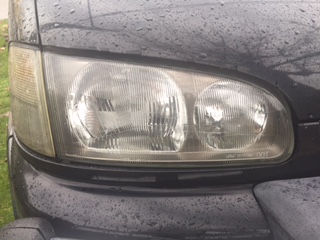

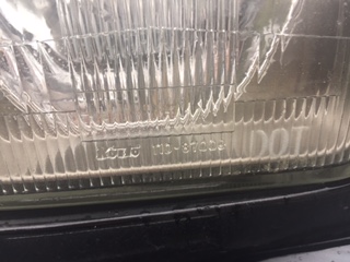

I recently bought a first generation L400 97 Delica from a dealer and it has DOT on inside of headlight. There is no E code on this headlight. Is this a illegal headlight for BC? I was informed by someone that it is not legal? That Delica never had dot headlights from Japan. Have I been scammed by the dealer?

I believe Canadian CMVSS standards accept DOT/FMVSS *and* European (E-code) headlamps, but for a definitive answer the man to ask would be Daniel Stern (http://www.danielsternlighting.com/).
Delicas didn't have DOT headlamps from Japan because they were not sold in the USA, but since yours has been converted to LHD headlamps you could have anything in there. It's entirely possible someone makes aftermarket LHD headlamps that have DOT certification.
