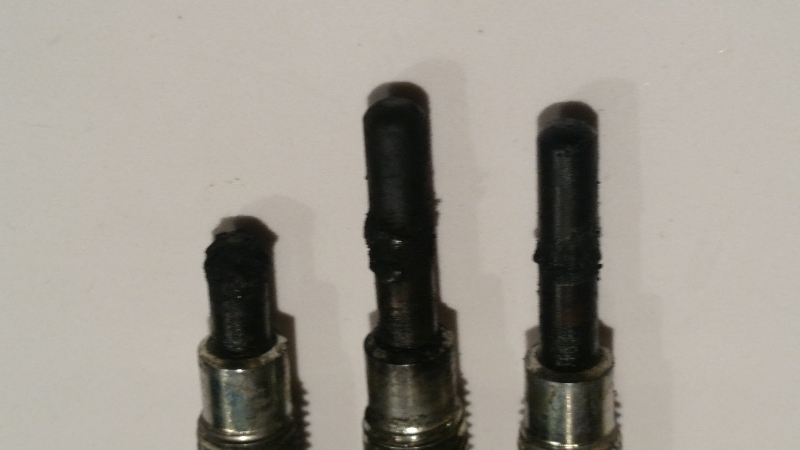

BE AWARE
So far Ive discovered two businesses that should know what they are doing selling the WRONG PLUG for the 4M40 2.8 turbo diesel.
Lordco sold me an NGK plug (2161 Y-116R1) that they assured me was a correct replacement part even though I showed them how different it was
from my OEM ones I was replacing.
Then I discovered Japanoid. By the picture on their webpage they are selling the same or similar plug as Lordco.
SO HERE IS WHAT HAPPENED
3 months later I found a local mechanic (about 1.5hrs away) that knows Delicas. He looked up the plug # I was using and told me to change them out
Right Away!
He gave me this plug # NGK 90066 CZ256. These had to be ordered in - from Lordco. They are a tapered narrow tip like the OEM ones I removed in May.
The first set of replacement plugs was the result of a *JDM guy* at my local Lordco looking up the part for me. The result was that the plug fit and my van started and ran fine BUT the diameter of the tip was too large and was burning on the sides where it was too close to the head. One of the plugs had melted so much the tip broke off.
Now I am getting ready to start up with the Right Plugs and am hoping and praying that there is no serious damage
Right Away!

Sadly the onus is on the installer to compare the replacement part with the original. There is enough reference material available out there that the obvious difference in the two parts could have been verified before installation and any damage avoided.
