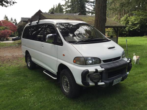

Hello All.
Sorry for the long story, thought It would be good to give the background on How I acquired my Delica aka Denisee (pronounced like Tennesse)
I have been considering getting a delica for a while, they have always been on my radar. And a couple of weeks ago I decided it was time.
I put my beloved 85 Toyota pickup up for sale. My original plan was to import my own as that seemed the most economical way to get one and I have connection at a shipping company.
However my friend who has also owns a L400 and has been helping me look posted up an add for one that was what I thought was an excellent deal.
It had a service history including over $1000 on the crankshaft pull and drive belts at CVI in the last month. The only thing reported as being needed was a CV boot which I thought was reasonable and should mean nothing else major needed doing.
It also has lots of extras such as HID headlights (which are amazing) a crazy audio system/back up camera (which is cool but I dont really need) and an inverter ( which was not hooked up.) and Limo tint in the back which will be good for camping.
The person I got it from seemed very honest and reliable and a long with the service history I felt comfortable putting down a deposit as my truck had sold very fast, and both mine and my wifes parents are visiting soon so would be nice to have the van.
So we headed down to Surrey last week to pick it up, the Previous owner included a couple of oilfilters, air filter, belts and spare guage cluster. it looked decent although I could tell it had been sitting a while. It fired right up and ran great on the test drive. everything works good, shifts smooth, transfer case good, lights good, electrics good. Considering the service history and the test drive we took it! although i did not give it as thorough inspection as I usually do (more on this later)
We had a great drive back! we were traveling in convoy as we had drove my wifes car down. We had the 2 ways going and headed to manning park, where we cooked dinner and spent the first night in the van! worked great the seat folded into beds worked great.
The next day we took a leisurely drive back including a nice morning stop at Cowboy cafe in Princton. Van ran great all the way back to Kelowna.
Yesterday my wife was out on her motorcycle and it broke down so I went to pick her and the bike up in the van. This thing is awesome!!
The Van was living up to everything we hoped it would be. Camper, Moto hauler, Work van, People mover, and more.
Now today I thought I better take a look at this CV boot, so I got my shoe goo out ( as I heard that is a good way to patch them) poked my head under only to discover oil everywhere! So it seems I have bigger problems. I am guessing some kind of gasket is gone. Hopefully not the head gasket I guess. Anyone have any advice? I will try and clean it and pinpoint the leak.
We have to go down to Van in a couple of weeks to the airport so I am thinking of booking it in to CVI for a once over. I also think a wheel bearing is on the way out.
I Got it for $6500 with 120,00km which I thought was good compared to once in stock at the dealers especially with the extras. Not so sure now as I am going to fix this leak. but I want to have this thing for a while and get it in top shape so need to get it done.
sorry for the long post. And thanks for everything, I have been reading lots of the threads over the last month.
Tom

So I have joned the Deli brigade. Pictures within.
- 1.jpg (43.51 KiB) Viewed 5716 times
