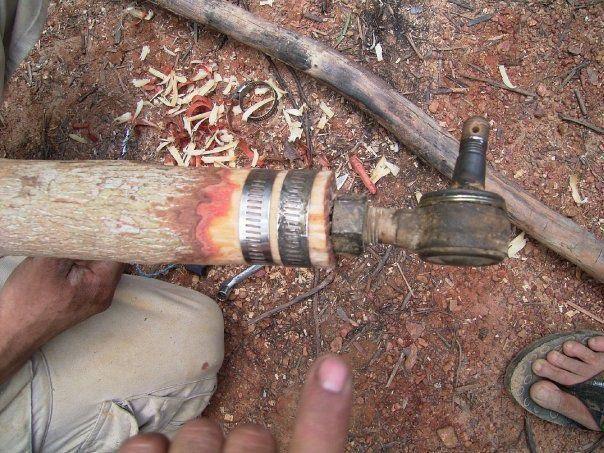

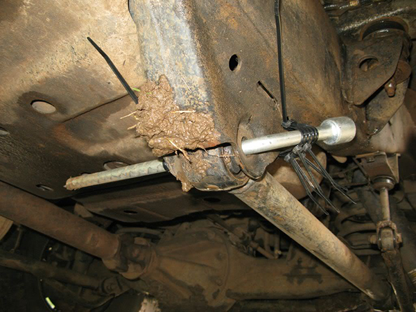

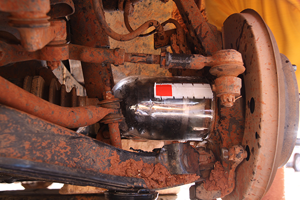

Bush mechanics can get you out of sticky situations.
Creative problem solving is the best tool.
However a good kit with the basic hand tools necessary for dissembling and assembling your car is important:
-a few spanners
-a few sockets and driver
-screw drivers
-pliers
-hammer
-air pump
And also a kit for quick bush fabrication:
-utility knife
-hack saw
-wire brush
-wire or cable ties
-hose clamps
-JB weld or similar putty
-butane lighter and solder
-etc............
So you can perform repairs like this :)
