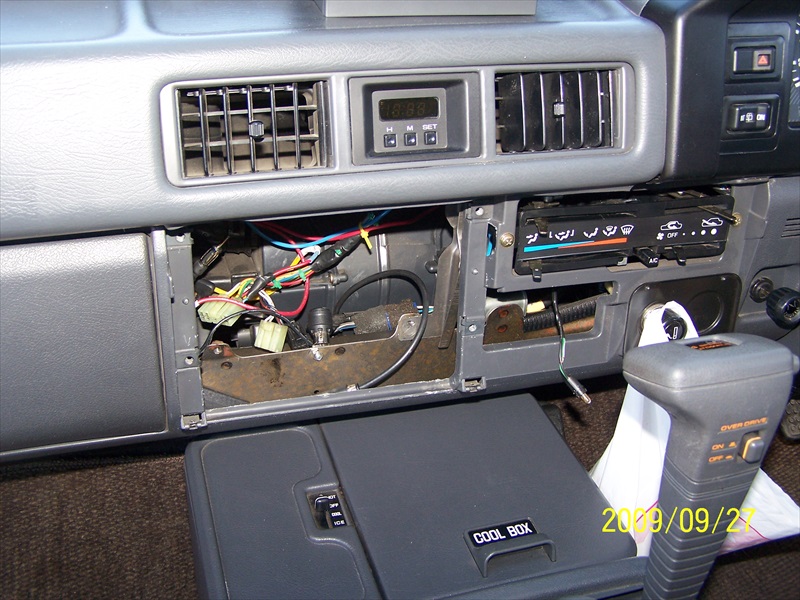

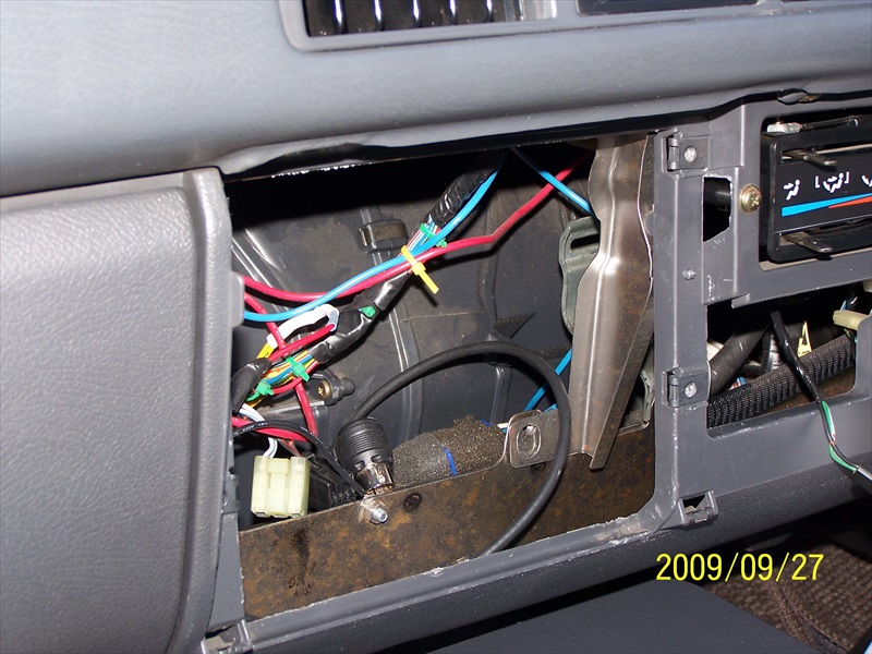

I can't remember the screw location but their are some on the bottom and I believe above the heater controls. I've attached a couple pictures of after it is off which may help. I don't think any are hidden,

Thanks for the reply and photos. I'm going to have another look tomorrow and see if I have better luck with things here.....
