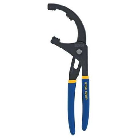

For removing oil filters: As the 4D56T oil filter is quite big, your typical oil filter tool, the kind with a metal strap? They won't fit over the filter. What you need is "sabre toothed adjustable pliers", like this:
Having said that, if you take a clean rag and wipe the residual oil off the filter, you can get a good grip on the filter with your hands and slowly twist it off. It takes time that way and is a bit of a workout, if you take my meaning. The pliers are way more convenient.
