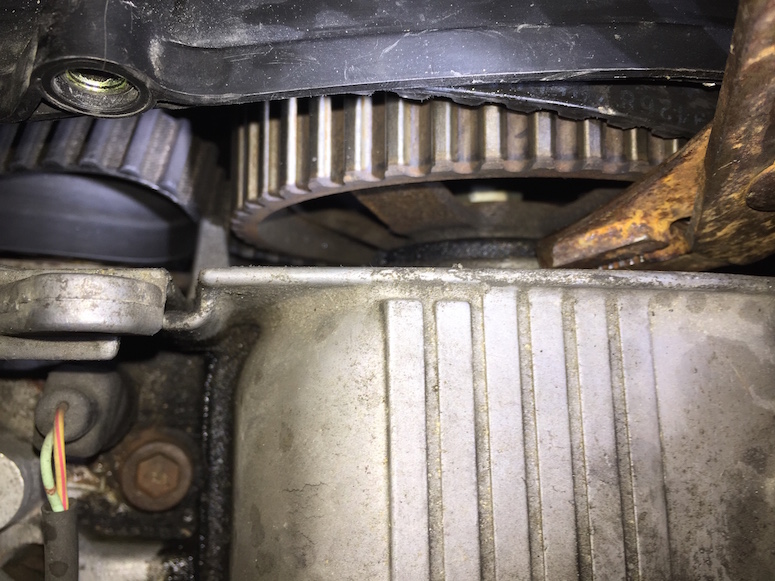

I took the two easy bolts out of the timing belt cover and saw the loveliness in the pics. Oh shit I said.
Now that myself and the interior of the Deli smelled like diesel, I figured I would cry and wait for the tow.

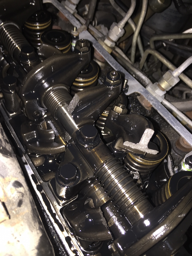

Re: Dorothy the Delica's Timing belt - the start of my saga.
Well...it seems things are looking just as they should
- IMG_0287.JPG (247.39 KiB) Viewed 9259 times

Ah man.. that really sucks.
I was hoping you got off lucky.

How bad are the pistons? I would suspect that the pistons have cracked, and will need to be replaced.

Pull the head to check the pistons are not damaged...
You are going to need to check the head or replace.... combustion chamber damage, bent valves (for sure), damaged guides, broken rockers etc....
Diesels are always interference motors due to the 20:1+ compression need to ignite the fuel..
Hopefully you got lucky on the inside... Broken lifters are good hopefully they failed before piston damage....

The rockers are deliberate weak spots, intended to break first- you'll have to strip the head and check for bent valves, but you might get away with just replacing the rockers.
Fingers crossed for you!
