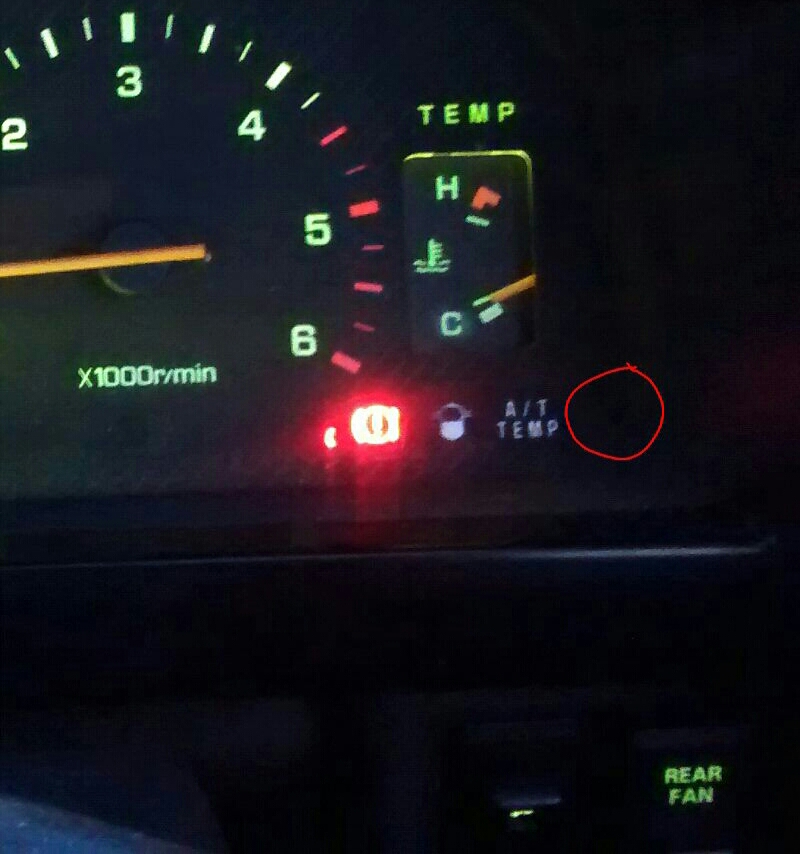

Its not the acorn looking one
The light i cant identify is hidden behind the dash plate to the right of the a/t temp. Can only see a little bit of the light lighting up 1/2 the p on the a/t temp bit. Did the manuals have a diffrent dash plates with different lights on them ? Ive tryed to upload a pic to show where it is

Hmmm... Oil?

I have now checked day and night and I don't have a light in that location guaranteed! Your dash layout must be slightly different than the KM/hr display we have.

Okay, I'm at my coffee shop and my wagon is just outside and I had a look. The idiot light to the right of the A/T Temp is (drum roll please): The seat belt light.
Perhaps when you take take it apart you might find that it was taped over. I'm thinking that the person who did the work didn't wear the seat belt and didn't like seeing the light on? Let us know, eh?

Oh ok I will have a play with the seat belt and see.
