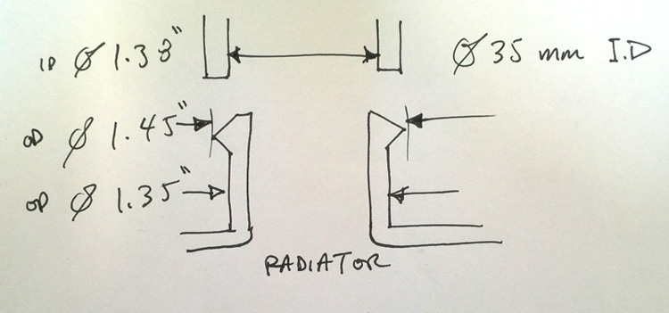

Does somebody know which size is the lower rad hose??? I tried to find the size on google but no success.. 1 1/4" - 1 1/2????

Re: Inline Coolant heater.
35 mm hose inner diameter, or 1 3/8" if available. 1 1/2" too big.
- IMG_20141117_125401 (2).jpg (81.59 KiB) Viewed 10549 times
