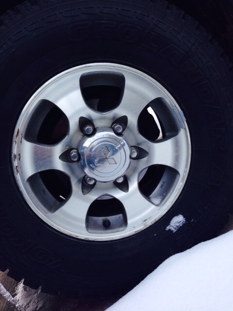

I've just got the stock Mitsubishi rims that came on the 98 Chamonix, I'll try to get a pic on. When I call tire shops and they ask "what are they going on" and I say "Delica", they are clueless. If Montero Rims are the same then I could say that because they will have it in their computer, because if it's not in their computer as far as they are concerned it doesn't exist.
So...Montero rims would fit?

Jackass
Posts: 14
Joined: Mon Mar 17, 2014 8:53 am
Vehicle: Delica
Location: Sherwood Park
Re: Rim Compatibility
Post by Jackass »
[img]
[/img]
Big-Bird
Posts: 1218
Vehicle: 96 PE8W Spacegear
Post by Big-Bird »
Montero should work. When L400 Delica owners need parts sometimes parts from the 3.5L Sport model Montero will fit. The logic should apply to rims as well.
