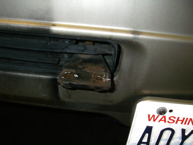

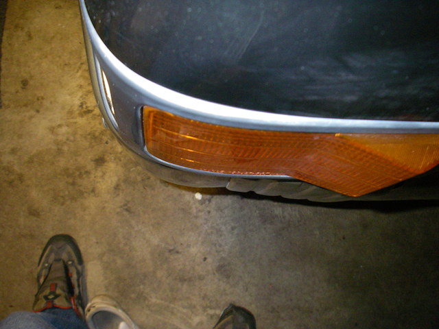

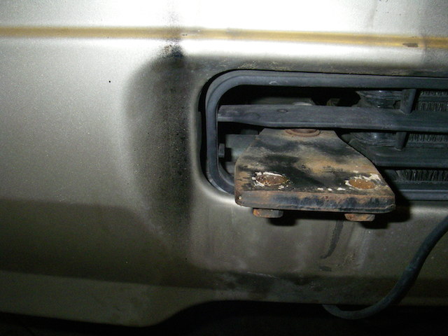

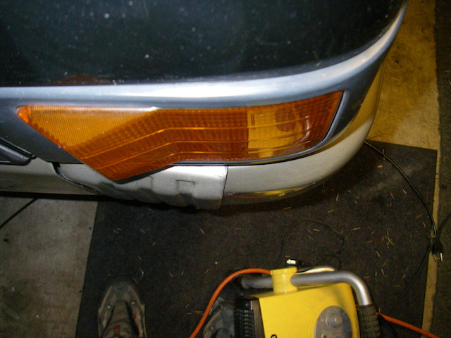

The photos show that the left side of the bumper as it wraps around the car, is slightly recessed from the headlamp surround, while the right side sits proud of the headlamp surround. The Bull bar mounts are also not symmetrical in the grille that they exit.

You're talking about the front lower body panel. That does look a little askew, doesn't it. It looks as though the right quarter is projecting and the left quarter has been pushed in a little. The upper and lower panels should line up (I just ran out and compared with my '92). If you go to the L300 Dedicated Category Reference Forum, in the Manual Downloads ~ there is a illustrated view of the underside in the Quick Reference Nipple Greasing Illustration. You can see the general shape of the frame. I'm wondering if either someone backed into the left quarter panel or maybe the previous owner slid into a tree or something. My guess, without crawling under my wagon would be to examine that part of the frame and how it connects with the panel. I'll wager that there's something bent between the frame and the panel. You can also see it in the two pictures of either end of the oil radiator grille, where they meet with the bush bar tangs, there's quite a difference where the grille sits in relation to the tangs.
