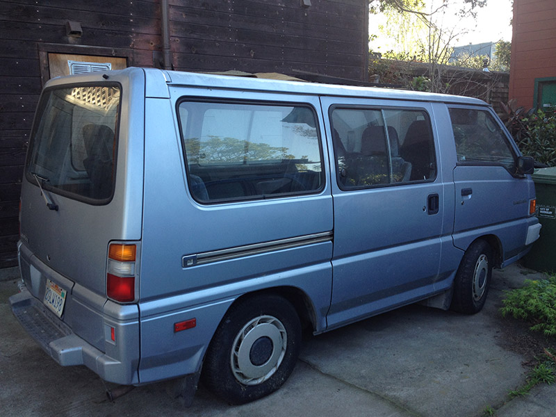

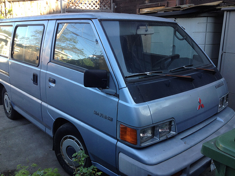

Here are some pictures.
- interior pano.jpg (94.19 KiB) Viewed 5618 times
- side.jpg (159 KiB) Viewed 5618 times
- front.jpg (174.33 KiB) Viewed 5618 times
