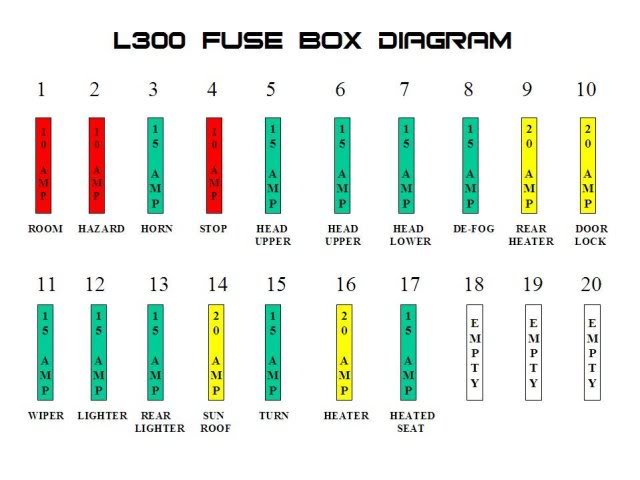

Here's the english version that I have..
Also, when you turn the key to start cranking, do you hear a 'click' from the starter? I'm not talking about the glow plugs but from the starter itself? Or a grinding sound? I've had the bendix part of the starter go before (both cars and planes) and sometimes a decent whack with a hammer can get one more start out of it..
vstrom

Dammit.. disregard that picture up there.. I just realized it has nothing on it from the ignition system.
