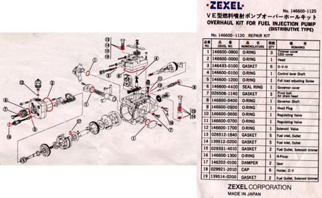

I have managed to trace it to the plug at the rear of the injection pump (roughly centred between the connections for the 4 injector pipes). From looking at the rebuild kit for the injection pump it looks like there is an o-ring seal behind this plug that has probably failed. (See image below).
Rebuild kit for IP
Rebuild kit for IP

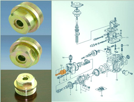

This plug is circular with three flat surfaces around its perimeter (spaced at 120 degrees?) ... in other words it looks like it needs a special tool to remove it. (see image below)
Image of part requiring special tool
Does anyone know what this special tool is called or where I can get it?

OK ... so I managed to pull the injection pump.
I ended up using a pipe wrench to loosen the plug I was worried about getting off ... that worked fine but in order to be able to swing the wrench I also had to remove the four connectors for the injector pipes.
I replaced the seal for this plug and reassembled / re-installed the injector pump. I had to bleed the pump by cracking the injector pipes open at the engine but other than that the van started fine and it looks like the leak is gone!
