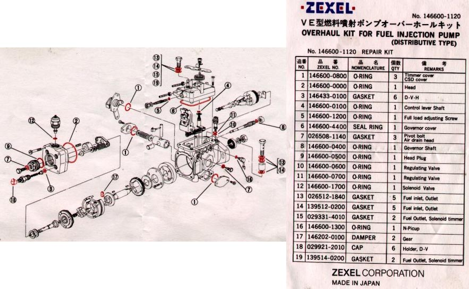

I have managed to trace it to the plug at the rear of the injection pump (roughly centred between the connections for the 4 injector pipes). From looking at the rebuild kit for the injection pump it looks like there is an o-ring seal behind this plug that has probably failed. (See image below).

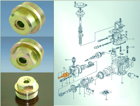

This plug is circular with three flat surfaces around its perimeter (spaced at 120 degrees?) ... in other words it looks like it needs a special tool to remove it. (see image below)
Does anyone know what this special tool is called or where I can get it?
