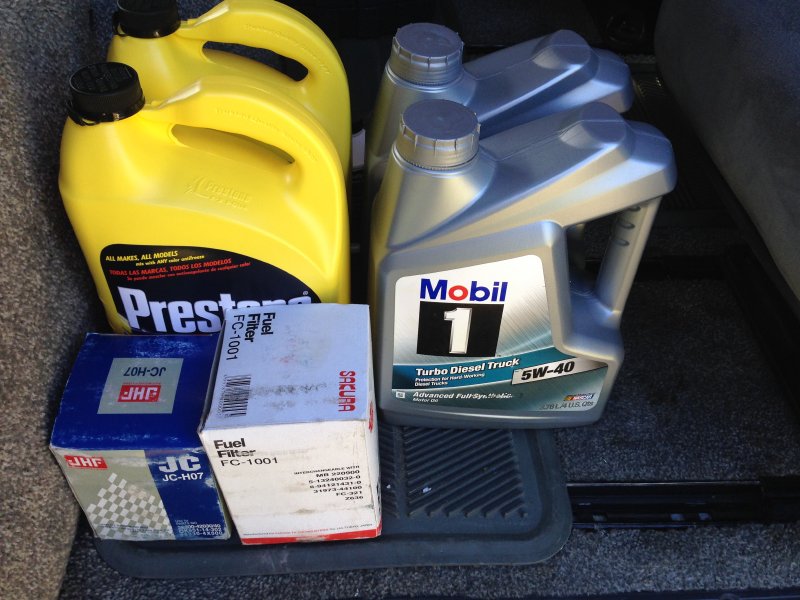

Having the block heater makes a huge difference. It starts up like it's the middle of summer (or at least fall :-) ). I also use Mobile 1 5W40 synthetic during winter months.
mobile 1.jpg (93.2 KiB) Viewed 7257 times
