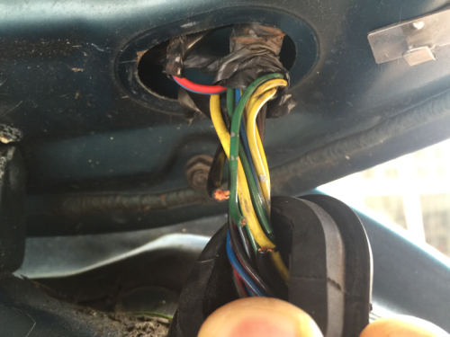

Well, I found that if I disconnect my rear light clusters on the gate that control the reverse lights that it DOES NOT beep when the brake is applied. Reverse still beeps normally.
However, hooking up either one of the reverse light clusters will cause it to beep when the brake is applied.
Any ideas?

check the condtion of the wires to the tailgate in the rubber boot, you could have a couple of breaks/shorts in there? my old dorf galaxy was prone to breaks /shorts in the looms where the cables entered the tailgate and doors! they would cause all sorts of problems! you would hit the brake pedal and the rear wiper would fire up! or the brake lights would come on as you flicked the heated screen :o

Yep, it was a break in the wiring harness right where the rear hatch opens. The break was hidden by the boot, once I found it and repaired it the short was gone!
