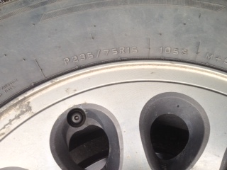

I have a set of almost new 235/75R15 tires. will these fit a stock Delica wheel, or do I need new rims for this? Also, will these fit a stock delica or do I need to lift it to fit these wheels?
-Andrew
-Andrew

well.. i am embarassed......
the tires i have are 31x10.5 R 15, not the previously mentioned 235-75R15's.. apparently there was a mismatched wheel sitting with them.
So.. will a 31" tire fit on a Delica without jacking it up?? also, how wide of a rim do i need for a 10.5" tire?

A 31" tire will not fit a stock height Delica.
They will rub.
I got 30" to go with no rubbing. On muddy or after driving
on the slushy/icy roads buildup on the fenders caused rubbing
fairly quick. 31's would be oooooh so worse. Maybe on metal
FS

Costco is best place to find uncommon tires. they can get anything from anyone, as their suppliers must meet strict contract rules or be fined. look online on the usa site also, and have shipped to bellingham costco etc.
Agreed that 30 inch is max without horrible lifts and mods.
cheers christine
cheers christine
