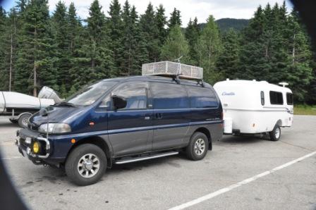

Re: Air bag support for rear suspension
I put in an Airlift 1000 Airbag. Sorry can't remember the model number but it was for a 95 Montero. Fairly easy install.
My back end used to sag and bottom out every dip and bump.
