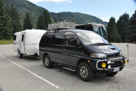

- Taking a break at Britton Rest Area.jpg (61.99 KiB) Viewed 6538 times
