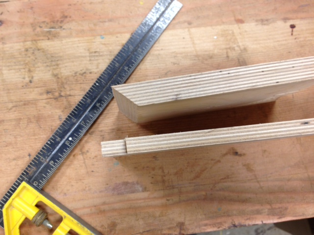

Baltic birch plywood , it comes in 5'x5' sheets , has very thin consistent veneers of hardwood and no voids, so you can use thinner sheets.

Re: Best (Ply)wood for bed costruction
Most lumber yards carry it around here, if you are in a Rona/Home Despot dominated region try looking under hardwoods in the yellow pages. Windsor Plywood carries it as well. A 12 mm sheet should run around $45.
The 5' size is nice for spanning across the van without joins.
- photo1.JPG (110.7 KiB) Viewed 6847 times
