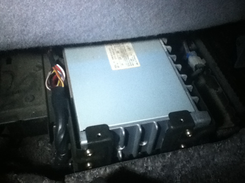

Is this the amp under the seat?
How much does it put out and with what kind of speakers can I replace the stock ones?

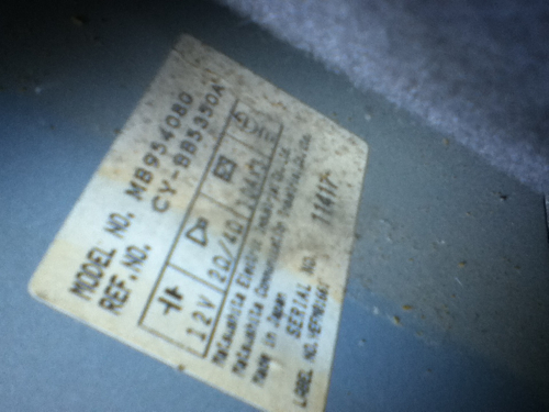

And the sticker.

The part number confirms its an amp but hard to tell the output as the sticker has voltage and ohm ratings but the last bit isn't clear....looks like 20A x 3 so that could be the fuse rating for the entire system.
Its very likely the output is maximum 25wattsx4 which is common for Mitsubishi audio systems that employed an amp in the design.
You could go to the local wrecker and pull some factory 6x9's from there....most OE speakers are rated around 15watts nominal (not peak) so they can easily handle 25watt max which is the best guess output of your stock system.
I have a set of 6x9's I pulled from an older Chrysler car late 80's early 90's vintage and they work great in my Deli. Happy hunting!

Big-Bird wrote:Hard to tell the output as the sticker has voltage and ohm ratings but the last bit isn't clear....looks like 20ampx3 but that can't be right....
I think it's 10Ax3. I can go check again. So what does that mean in terms of changing speakers? What am I looking for?
Thanks Big-Bird.
