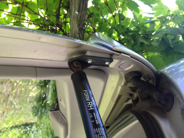

L400 Rear Hatch Lift
Just added 10mm thick blocks to the top mounting brackets and that gave a me 52mm lift to the tailgate
Also used longer screws.
Could probably go as much 14mm but that was the material i had.

Re: L400 Rear Hatch Lift
For to avoid head bonking and general hair mussing when hanging out under the tailgate

What sort of blocks are these, and where can I obtain some?
- Artacoma
- Posts: 569
- Vehicle: 97 V6 LWB
- Location: Victoria BC
I used some UHMW plastic pieces , nylon or dense wood would work as well, maybe aluminum.
Is this on top of flipping the brackets around??? I'm really hoping so.
Flipping the gas struts around only works on L300 s.kurtiswilk wrote:Is this on top of flipping the brackets around??? I'm really hoping so.

I had been meaning to do this for ages. Finally spent $8 on eBay and just ordered this:
Delrin Virgin white sheet 0.625'' x 3'' x 3.875'' Made in USA CNC (0.3C)
Tried to take the struts off, snapped a bolt instantly. Damn.
