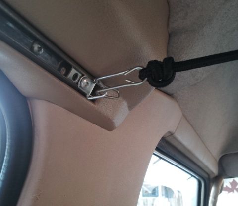

For SvR we just ran a stretch cord just behind the front seats (Hooked to the ends of the curtain rails). It was attached via picture frame hardware (adjustable hangar loops that fit perfectly into the rails). Then we threaded a curtain across.

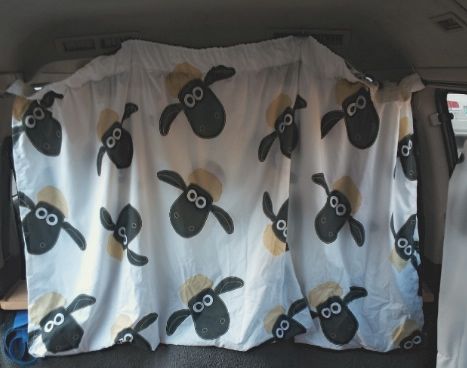

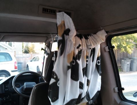

Re: Camperizing The Delishhh??
Here is my set-up.
The fame hangars fit perfect in the channels. The stretchy cord and u-hooks I had lying around and to hold the top up I used traditional curtain hooks.
- Detail of attachment
- curtain2.jpg (24.05 KiB) Viewed 5485 times
- In the "normal" position
- curtain3.jpg (32.59 KiB) Viewed 5485 times
- When closed
- curtain4.jpg (29.73 KiB) Viewed 5485 times
BAHahahahahahaha
