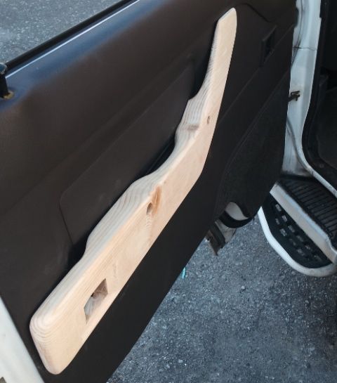

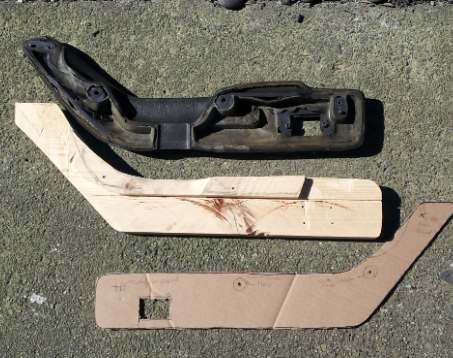

Started a few days ago with the old (passenger side) one off in order to make a template.
Got a stick of wood - my skills aren't the best so I opted for pine. A good shellacking should keep it pretty!
Cut out the rough shape and spent most of today between a belt sander, table saw and hand sander.
I'm quite happy with it. Not perfect, but it will do the trick. Just need to give it the finish and screw it completely back into place. Then make the other side.
Best part is it fit with very little swearing and adjustments.
- The light will work when I replace the bulb.
- door handle1.jpg (18.55 KiB) Viewed 2909 times
- The seconde fitting.
- door handle3.jpg (38.97 KiB) Viewed 2909 times

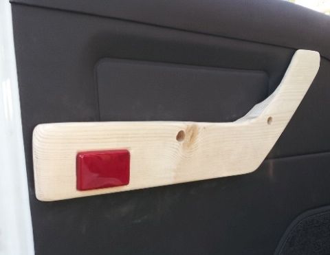

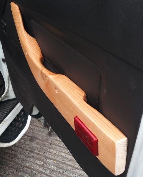

The armrests are complete.
The first one went together with nary a hitch. The other side? Well let's just say I rushed it a little and after buggering up two blanks I got the third one right (almost) - A tad long but the table saw took care of it.
Best thing is when you open the door the lights come on!!!

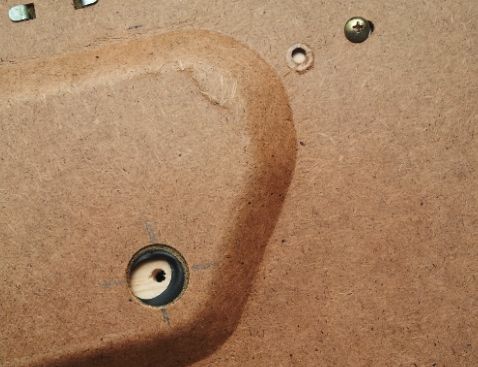

- Let's hope that the holes line up?
- door handle11.jpg (35.64 KiB) Viewed 2802 times
- Drivers side complete.
- door handle12.jpg (37.42 KiB) Viewed 2802 times
